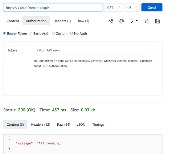

Finally, there’s an online way of testing the API URL too, thanks to REQBIN.
Just make sure you add the trailing \ to the URL for this test, and then remove it for the correct API URL on success.
