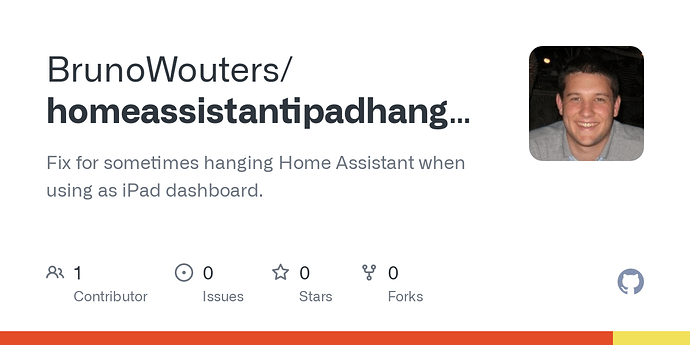

To temporary(?) solve this I created a workaround where I load the HA dashboard in an iframe.
When HA stops sending the iframe messages the iframe is reloaded.
I’m still fine tuning it but it seems to work for now.
You will need to load HA in a browser instead of the app (or Kiosk+ app). I still have the app installed to receive notifications to wake up the screen.
