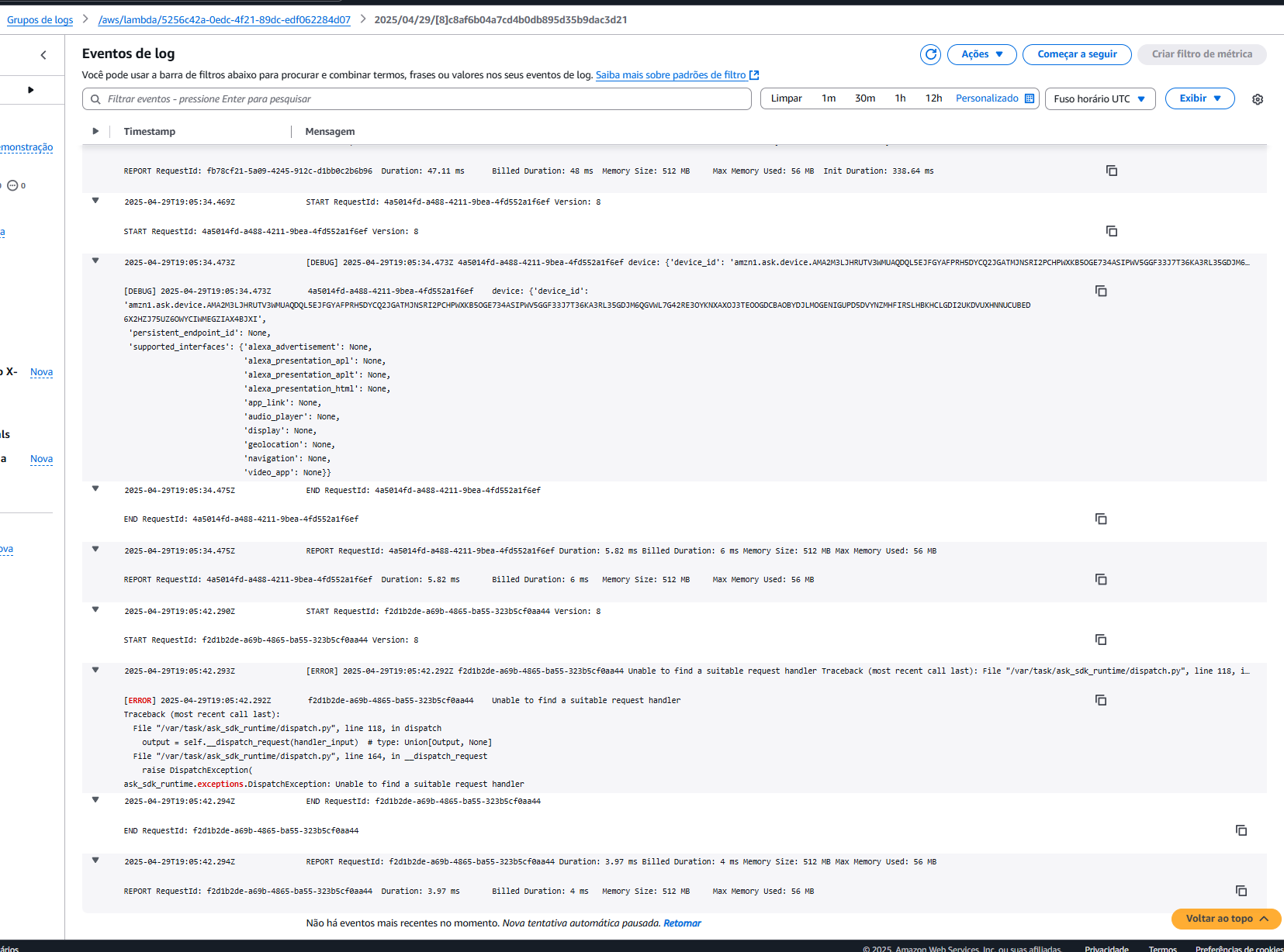

Hi Fabian, I dont know if it is only with me, but when I try to send a command, I get this erros on log:
What version are you using?
Is possible to attach all logs?
hi fabian.
this is the entire log screen, when sending the activate, it works fine.
but when I try to do some actions ( command or open dash ), I got this error.
The version is the latest from GitHub, I just imported it yesterday.
