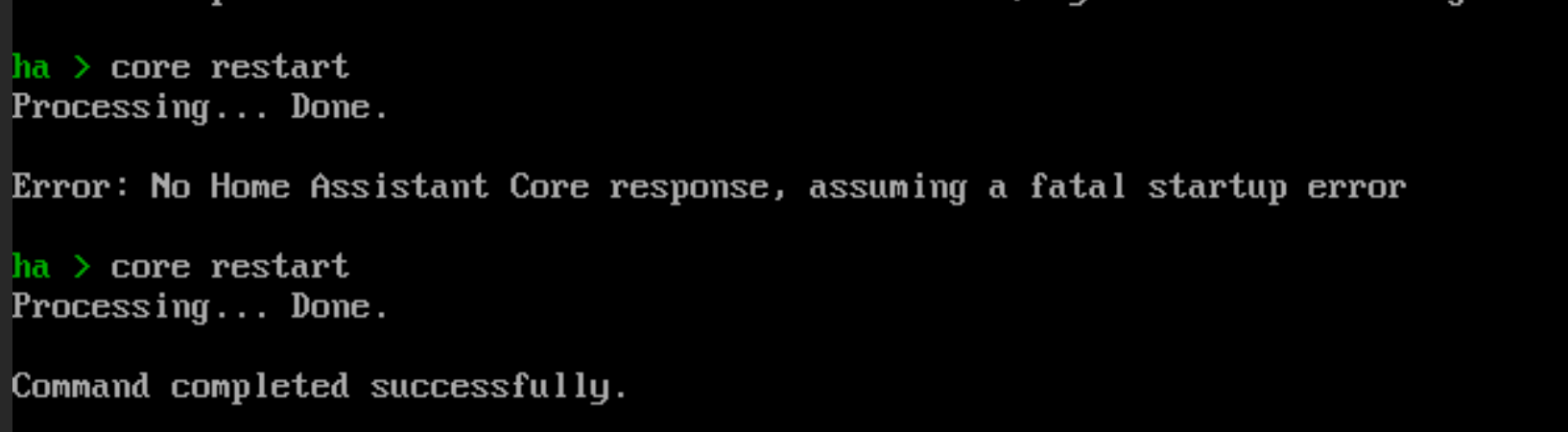

I have a similar issue. I have not found the best way of dealing with this ( (re)boot issues, how to debug - Installation - Home Assistant Community).
Doing a supervisor repair and or restart somehow does this trick for me.
try:
ha su repair
it can take some (long) time. and sometime it fails.
Another option is to do a supervisor restart:
ha su restart
or a core restart (not sure about the syntax):
ha core restart

The supervisor will try 2 reboots, and if it is not successful, it will try the other ‘slot’ which is the prior version.
Sometimes it says:
Other times running banner
And then after that it’s not waiting at all.
Does that possibly mean something
