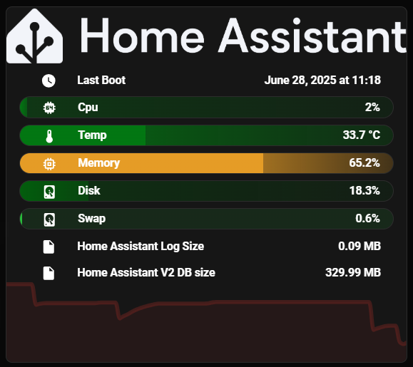

Home Assistant card (replacing former bar-card config)
Added a Home Assistant Log Size sensor, using the File Size integration.
Card code with border: 1px groove var(--divider-color)
type: entities
entities:
  - entity: sensor.system_monitor_last_boot
    format: datetime
    card_mod:
      style: |
        hui-generic-entity-row {
          border: none !important;
  - entity: sensor.system_monitor_processor_use
    card_mod:
      style: |
          background:
            {% set perc = states(config.entity)|float(0) %}
            {% set rest = 100 - perc %}
            {% if perc >= 59 %} {% set bar = '255,0,0' %}
            {% elif perc >= 44 %} {% set bar = '128,0 0' %}
            {% elif perc >= 24 %} {% set bar = '255,165,0' %}
            {% elif perc >= 9 %} {% set bar = '0,100,0' %}
            {% else %} {% set bar = '0,128,0' %}
            {% endif %}
            /*linear-gradient(to left,ivory {{rest}}%, {{bar}} {{perc}}%);*/
            linear-gradient(to right, rgb({{bar}},0.9) 0%, rgb({{bar}},0.6) {{perc}}%,
                                      rgba({{bar}},0.3){{perc}}%, rgba({{bar}},0.1) 100%);
  - entity: sensor.system_monitor_processor_temperature
    card_mod:
      style: |
          background:
            {% set temp = states(config.entity)|float(0) %}
            {% set rest = 100 - temp %}
            {% if temp >= 85 %} {% set bar = '255,0,0' %}
            {% elif temp >= 75 %} {% set bar = '128,0,0' %}
            {% elif temp >= 65 %} {% set bar = '255,99,71' %}
            {% elif temp >= 55 %} {% set bar = '255,69,0' %}
            {% elif temp >= 45 %} {% set bar = '255,140,0' %}
            {% elif temp >= 35 %} {% set bar = '255,165,0' %}
            {% endif %}
            /*linear-gradient(to left,ivory {{rest}}%, {{bar}} {{temp}}%);*/
            linear-gradient(to right, rgba({{bar}},0.9) 0%, rgba({{bar}},0.9) {{temp}}%,
                                      rgba({{bar}},0.6){{temp}}%, rgba({{bar}},0.2) 100%);
  - entity: sensor.system_monitor_memory_usage
    card_mod:
      style: |
          background:
            {% if perc >= 85 %} {% set bar = '255,0,0' %}
            {% elif perc >= 75 %} {% set bar = '128,0,0' %}
            {% elif perc >= 60 %} {% set bar = '255,165,0' %}
            {% elif perc >= 50 %} {% set bar = '165,42,42' %}
            {% endif %}
            linear-gradient(to right, rgba({{bar}},0.9) 0%, rgb({{bar}},0.9) {{perc}}%,
                                      rgba({{bar}},0.6){{perc}}%, rgba({{bar}},0.2) 100%);
  - entity: sensor.system_monitor_disk_usage
    card_mod:
      style: |
          background:
            {% endif %}
  - entity: sensor.system_monitor_swap_usage
    card_mod:
      style: |
          background:
            {% set swap = states(config.entity)|float(0) %}
            {% set rest = 1000 - swap %}
            /*{% set factor = 0.06 %}*/
            {% if swap >= 768 %} {% set bar = '255,0,0' %}
            {% elif swap >= 640 %} {% set bar = '255,215,0' %}
            {% else %} {% set bar = '50,205,50' %}
            {% endif %}
            /*linear-gradient(to left,ivory {{rest*factor}}%, {{bar}} {{swap*factor}}%);*/
            linear-gradient(to right, rgba({{bar}},0.9) 0%, rgba({{bar}},0.9) {{swap}}%,
                                      rgba({{bar}},0.1){{swap}}%, rgba({{bar}},0.1) 100%);
  - entity: sensor.home_assistant_log_size
    name: Home Assistant Log Size
    card_mod:
      style: |
  - entity: sensor.home_assistant_v2_db_size
    name: Home Assistant V2 DB size
    card_mod:
      style: |
header:
  type: picture
  image: /local/home-assistant/home-assistant-wordmark-monochrome-on-dark.png
  tap_action:
    action: none
  hold_action:
    action: none
footer:
  type: graph
  hours_to_show: 168
  detail: 1
card_mod:
  style:
    hui-sensor-entity-row:
          height: 25px;
          padding: 0px 16px;
          border-radius: 24px;
          border: 1px groove var(--divider-color);
      .card-content {
        background: var(--ha-color);
      ha-card {
        color: white;
        --card-mod-icon-color: white;
        --mdc-icon-size: 20px;
        font-weight: bold;
