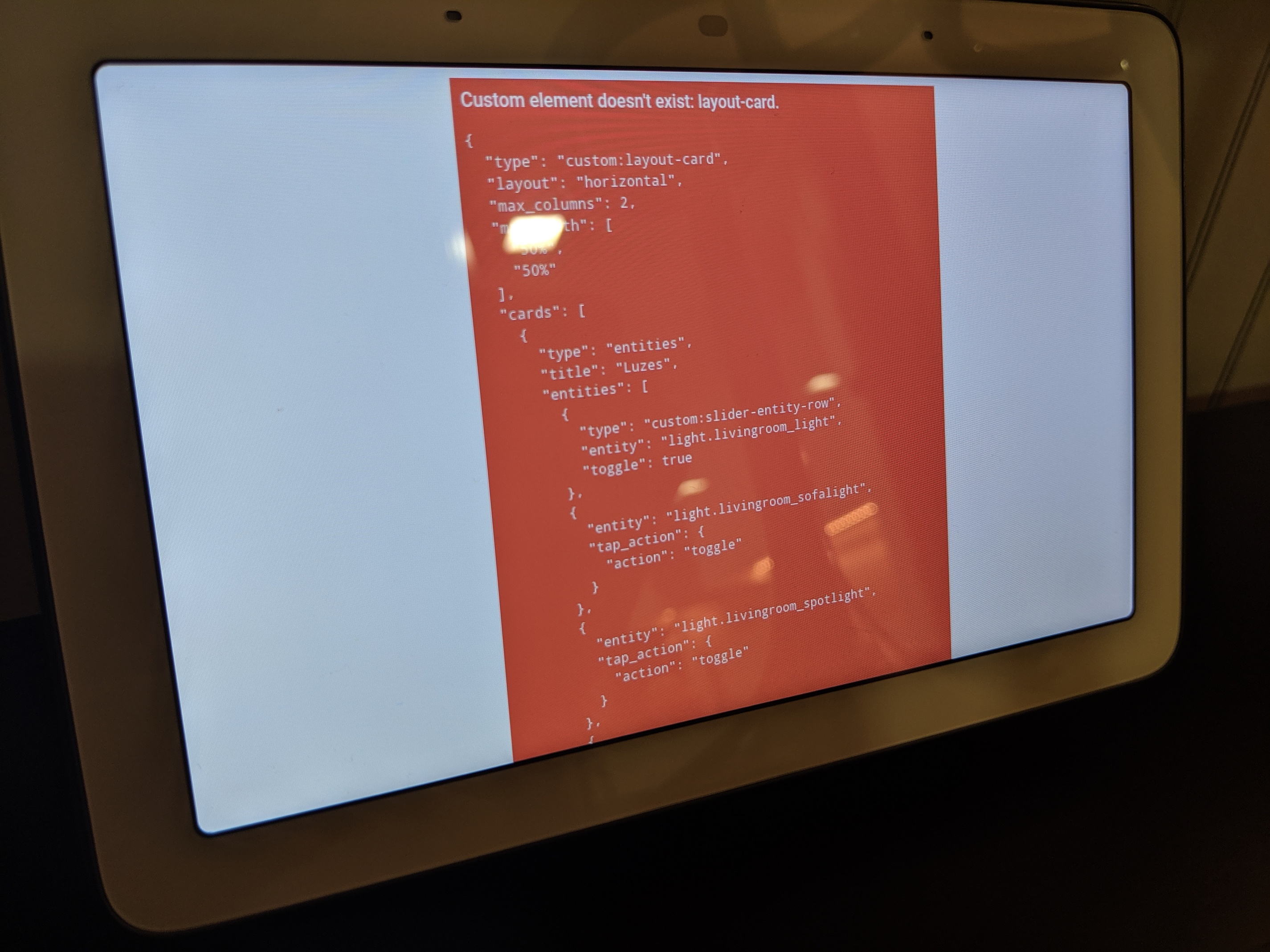

Have the exact same problem? Any solution? Proxying using Nginx…
I tried with a view with no Custom Cards and it worked. So I guess non of my custom cards can be rendered…
