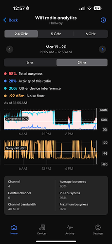

Attached the Eero wifi radio analysis
You say you have the same setup, but are you 100% sure the settings for the new routers are the same as the old ones? Any chance you can fire up the Eero6 so you can compare settings?
For example, I see in your screenshot that your channel bandwidth is set to 40 MHz. Some Wifi devices don’t like that and only run stably at 20 MHz.
You are also using channel 4, which is prone to interference from channels 1 & 6 (both very commonly used channels).
Also, you say this issue starts at 5AM. Are you sure it’s not slightly earlier? HA does its daily recorder cleanup at 4:12AM, and if you set up automatic backups, those run at around 4:45AM.
Try to get your network settings in the same state as they were previously and monitor for the issue. If it’s still happening, the next place you should look is in the logs for the TPLink switch integration (or whatever way you integrated those switches).
