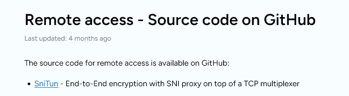

It is end to end encrypted.
https://support.nabucasa.com/hc/en-us/articles/26510075061021-Remote-access-Source-code-on-GitHub
Well, that certainly takes the edge off
