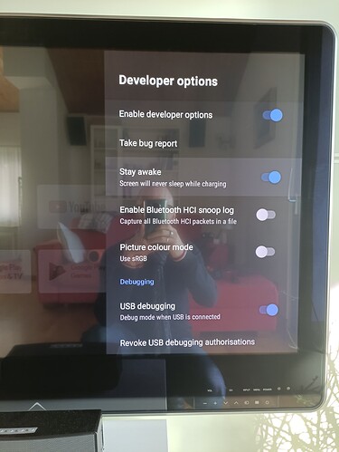

Hi, do you have the “Stay awake” element in the developer options?
I had that problem too but resolved not letting the box to go sleeping.
No, it is A/C only (no battery) so there’s no “Stay awake (screen will never sleep while charging)”…
I’m pinging my tv from home assistant to prevent it from going into deep sleep.
Okay, pity, my Xiaomi TV box 4k is on AC power but has it, so probably it depends on the producer.
