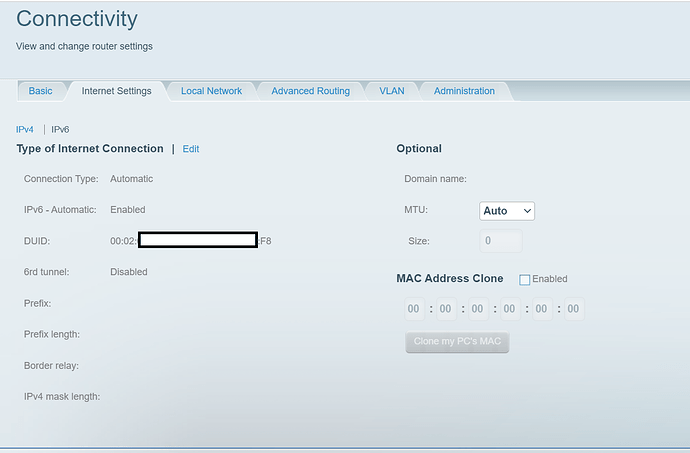

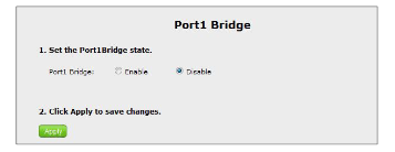

From what I understand, bridge-mode turns the router into an ethernet swithch, but port 1 (Lan 1) is the passthough. Should it be doing DHCP or not? I have to physically go to the router to check it because its not accessible anymore on my home network…so I will check for this and get back to you on this point.
- Here is what is under internet settings:
IPv4:
IPv6
- Its actually quite simple to put the router in bridge mode, instructions here untill you get this main page
and just hit apply

I’m not sure about this, because I don’t want my actiontec to do an NAT, just the linksys. The Linksys “internet in” is connected to port 1 of the Actiontec.
You are right about this becuase I actually cannot access my Actiontec when typing its IP (192.168.1.254) and I may be mistaken above with the photo showing the Actiontec as a client because its a 7 day plot, so it could be just history and will dissapear soon.
So, could the problem here be that my Actiontec is also doing DHCP?
