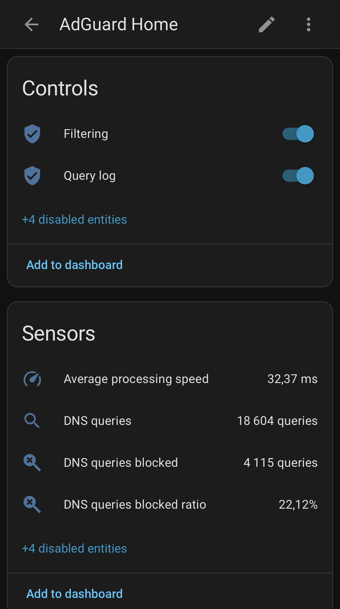

is it possible to use the AdGuard integration to control the app or how is it possible to switch on/off filtering with an entity?
Best regards
Michael
Yes it is, the integration will give you controls to turn on off filtering
