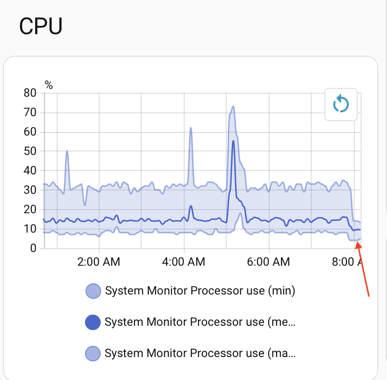

I recently decided to give a new try to Glances. In the past I would always end up disabling it due to high cpu consumption on my server. As my instance was about to become unsupported at the end of the year, I decided to migrate to Proxmox and I’m now running HAOS on a VM inside Proxmox on an Intel NUC 8th gen (i5, 16GB RAM).
I installed Glances anew 2 days ago and found again that CPU would increase from 5/10% to a sustained 30%. I don’t think this considerable CPU spike is expected.
I tried increasing the refresh_timeparameter but results haven’t change. Also, I always kept the option process_info disabled throughout the observation time.
Any hint as to how to configure the add-on to reduce CPU load on my server? Note that the red arrow indicates when I decided to disable the add-on. CPU got significantly reduced.
thanks in advance!
