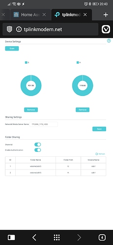

I think the Root Directory is the issue.
192.168.1.1 is the server
video is the share
I can’t figure out what you want to achieve with the Root Directory since it just points to a folder in the share. The naming of the folders in that share seem strange to me.
Do you really want to store the files to:
192.168.1.1/video/volume(sdb1)/Home re....
I think you want:
192.168.1.1/video/Home recordings/Front Door
So Root Directory should be /Home recordings/Front Door

Here’s the router settings.
Ideally i just want 192.168.1.1/Home recordings/Front Door
Ive tried all the protocols but the same error with all of them.
Yes i did wonder about that but ive got it set to record on motion only and the settings are very low sensitivity so it only records about 6 or 7 things a day. Do you think that will be ok?
the share name is sdb1
the root directory is Home recordings/Front Door - you may need to put quotes around that.

Woohoo, that worked! Had to put share name in as volume(sdb1) but finally connected!! Thanks for the help Nick and @eXtatic

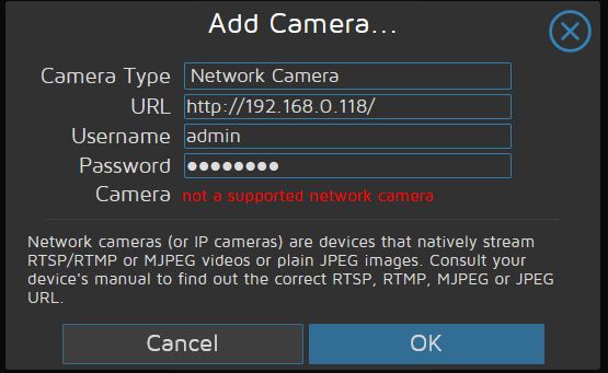

Hello every one!
I’ve just bought Hikvision DS-2CD2T22WD-I5 camera.
i have acces to live view through iexplorer http://192.168.0.118/doc/page/preview.asp
I try to this cam to my fresch instaled MotionEye on HassOS 4.11. But motioneye shows me this ā€˜not a supported network camera’
Przechwytywanie
Is there list of supported cameras? or what functionality not support motioneye?
so i can check it before buying a new one. or I’m doing something wrong…
Found solution. Input in URL field ā€œrtspā€ insted of" http". Now I start playing with functionality of this add-on :smiley:
