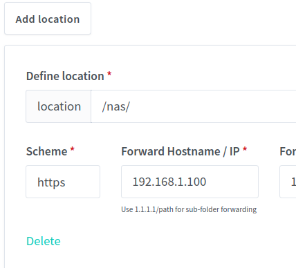

Did you get this figured out? Im having the same problem, I want to access my NAS, transmission etc.
Still hoping someone can assist here, I’ve not used a reverse proxy before but i’ve done a lot with redirects in the past and am stumped as to why the rewrite isn’t working.
So imjust having a play around and can access my NAS!!! I cant access anything over http though
Screenshot from 2020-06-16 16-39-15
I had to add the slash at the end of nas
