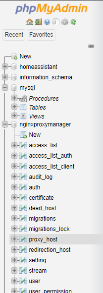

You can find the proxy list in NPM addon at /data/nginx/proxy_host or in MariaDB addon (I think the easiest way to poke into MariaDB without SQL knowledge is via phpMyAdmin community addon and you’ll find the list under proxy_host).
@Petrica Oh wow that is really good to know. Is there a particular column under proxy_host that should have the details. I feel like I sift through each but the data doesn’t appear to help, but more than likely I just don’t understand what I’m looking at haha.
In Browse tab the main info you’re interested in are located on columns domain_names, forward_host and forward_port.
@Petrica aha, I guess I may be having more issues than I thought. There are no entries at all for me, which I guess would correlate as to why my GUI is all blank. However, doesn’t speak toward how all my connections are still working. I validated by stopping NGINX and everything breaks, start it up and it works, yet I can’t see anything in the database… Very strange.
