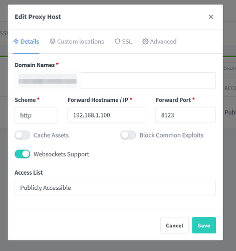

This is the first time I’m working with this add-on since I just purchased a custom domain name. My goal is to forward plex.mydomain.com to my Plex server, ha.mydomain.com to my Home Assistant installation, etc.
The proxy hosts look like this:
The one for Plex works great. The one for HA however results in ā€œ400: Bad Requestā€. However, when I navigate to ha.mydomain.com:8123 it does work. But obviously I don’t want to enter the port number in the url.
My Home Assistant in itself is also able to resolve on a custom.duckdns.org:8123 domain but putting that as the destination gives the same error message.
Any ideas what I might be doing wrong here?
Edit: Nevermind. Bad case of RTFM: HTTP - Home Assistant
