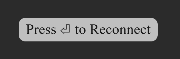

I just installed SSH& Web Terminal. When I start it I get the error S02 bad gateway. How to fix this error. THANKS

I have the issue that after start of the terminal screen I get “press enter to reconnect” and after pressing enter the same message again.
I checked the logs and get the following message
[2025/05/22 12:12:02:0465] N: __lws_lc_tag:  ++ [wsisrv|16|adopted] (1)
[2025/05/22 12:12:02:0475] N: HTTP /token - 172.30.32.2
[2025/05/22 12:12:02:1917] E: lws_process_ws_upgrade: malformed or absent conn hdr
[2025/05/22 12:12:02:1919] N: __lws_lc_untag:  -- [wsisrv|16|adopted] (0) 145.387ms
[2025/05/22 12:12:02:1931] N: __lws_lc_tag:  ++ [wsisrv|17|adopted] (1)
[2025/05/22 12:12:02:1937] E: lws_process_ws_upgrade: malformed or absent conn hdr
[2025/05/22 12:12:02:1939] N: __lws_lc_untag:  -- [wsisrv|17|adopted] (0) 787μs
In supervisor log it shows
2025-05-22 12:12:02.194 ERROR (MainThread) [supervisor.api.ingress] Ingress error: Server disconnected
SSH access is working fine…
My guess is that the AddOn has been configured to use port 22222 instead of 22. Check the AddOn’s config tab and see what it says.
I solved it.
It had to adapt the headers in my reverse proxy settings. Locally it was already working but any remote access was not working.
