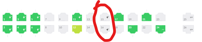

@frenck is there a way to control poe power to a device that has no mac address? I am basically using poe to charge 2 tablets and want to be able to switch them on and off but the ports dont show up in the integration. Is there a way to specify a port you want to switch?
look at port 15 and 16
