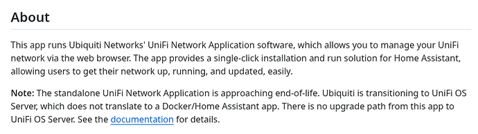

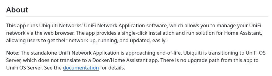

So, how do you all go about the end-of-life of this application, regarding GitHub - hassio-addons/app-unifi: UniFi Network Application - Home Assistant Community Apps · GitHub
Well this really sucks!! I just came across this add-on and I thought it would be a great addition to my HA system. Now I cannot use it anyway.
Thank you Frank for all your work and kindness toward the open source and home assistant community.
