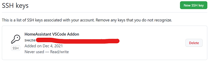

When trying to synchronize github from within VSCODE addon I get
I have created token using ssh-keygen and ssh-add and created the relevant token in github website.
ssh -T seems to work
ssh -vT also sees to work
Update:
I solved it by creating a key without a passphrase
