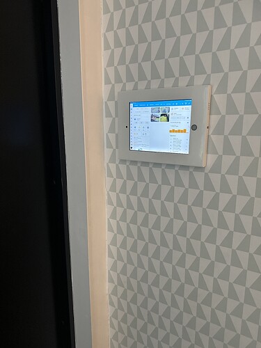

I’m using an iPad Air 2 as a wall panel with the iPad companion app.
Works like a charm.
My setup for automatic sceeen saver and wake up is:
  1. Use guided access to automatic make the screen blank.
  2. A motion sensor in the same room push a notification to the device that makes it wake up when someone is in that room.
Might you explain a bit more, pls.
Yor iPad air’s display is on as long someone is in the room or does it blank after a (short) period of time?
Sure.
On my iPad I set the screen to go blank after 2minutes.
Then I enabled guided access on the iPad, this is a way to be able to hide the notifications to the iPad.
To wake that sceeen up I simply send a notification to the iPad via home assistant when the motion sensor in the same room detects motion.
After 2min the screen automatically go blank again.
The last 3years since the iPad was installed I had it with the screen always on, but at last I found out a solution to blank it.
Another good thing about this is that it doesn’t consume traffic on my WiFi (I have cameras displaying live views).
