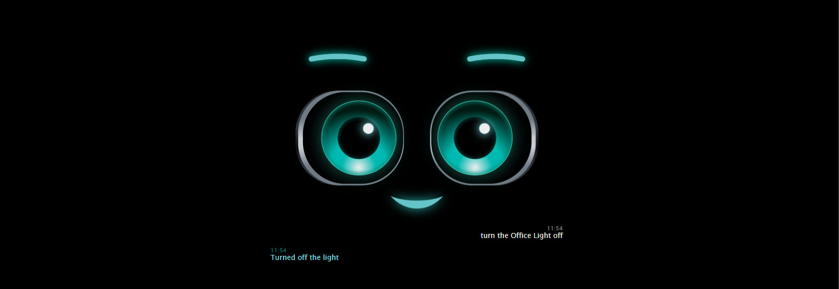

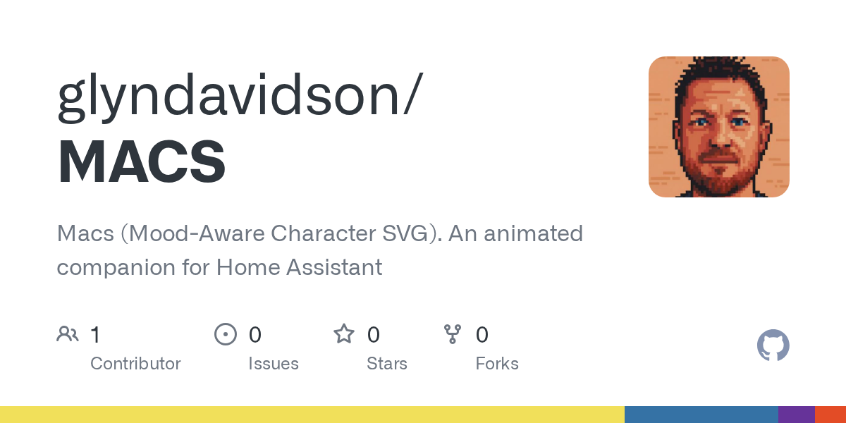

Try this:
It would be nice to share examples of cards.
