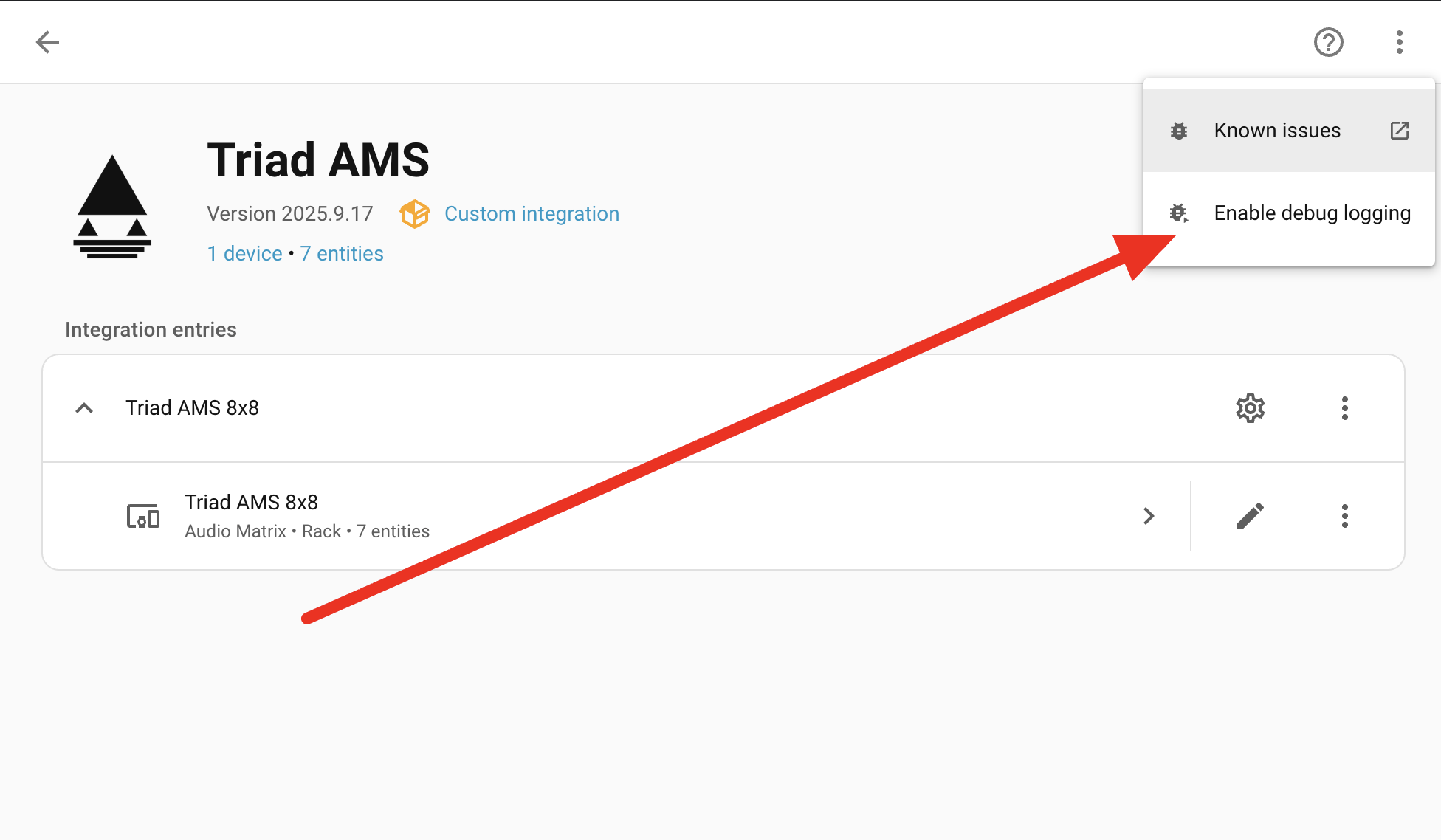

Let’s see what we can figure out. The first thing to do is to enable debugging and see if we can get that to give us some useful information.
Once this is enabled, you can either grep your home-assistant.log or, if you don’t know what that is, try a few operations and then disable debug logging and it’ll download a log file for you. Search that log file for lines that contain triad_ams and you’ll see lines like this:
