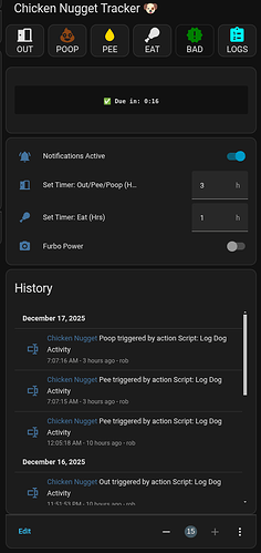

2) What it Does
This project adds a compact “Potty Tracker” widget and backend logic to Home Assistant. By tapping a button when an event occurs, you update a “Due Time,” and Home Assistant alerts you via mobile notifications when that time expires. It’s more of a human automator than involving smart devices. No doubt this could be adapted for many other things beyond dog training.
Key Features:
  • One-tap buttons: OUT / PEE / POOP / EAT.
  • Accident Modifier (BAD): A toggle to tag the next entry as an indoor accident for pattern tracking.
  • Live Countdown: A “Due in / Overdue” markdown display.
  • Dual Timers: Configurable intervals for standard outings vs. immediate post-meal needs.
  • Smart Sleep Windows: Notifications only auto-enable if the next timer lands between 06:00 and 22:00.
  • Anti-Spam Alerts: Overdue notifications fire in specific windows (Immediate, 10m late, 30m late).
NOTE: I have a “BEDTIME” script that turns off the notifcation switch when I go to bed.

D. Dashboard Card (Lovelace YAML)
type: vertical-stack
title: Dog Potty Tracker 🐶
cards:
  - type: grid
    columns: 6
    cards:
      - type: custom:button-card
        icon: mdi:door-open
        tap_action:
          action: call-service
          service: script.dog_log_activity
          service_data: {activity_type: Out}
        show_name: true
        icon: mdi:emoticon-poop
        tap_action:
          service_data: {activity_type: Poop}
        show_name: true
        icon: mdi:water
        tap_action:
          service_data: {activity_type: Pee}
        show_name: true
        icon: mdi:food-drumstick
        tap_action:
          service_data: {activity_type: Eat}
        show_name: true
        entity: input_boolean.dog_bad_modifier
        icon: mdi:alert-decagram
        show_name: true
        tap_action: {action: toggle}
        styles:
          card:
            - background-color: "[[[ return states['input_boolean.dog_bad_modifier'].state === 'on' ? 'red' : 'initial'; ]]]"
        entity: input_boolean.dog_show_log
        icon: mdi:clipboard-list
        show_name: true
  - type: markdown
    content: >
      <center><h2>
      {% set due_state = states('input_datetime.dog_due_time') %}
      {% if due_state not in ['unknown', 'unavailable'] %}
        {% set due = due_state | as_datetime | as_local %}
        {% set remaining = (due - now()).total_seconds() %}
        {% if remaining > 0 %}
          ✅ Due in: {{ (remaining / 3600) | int }}:{{ '%02d' % ((remaining % 3600) / 60) | int }}
        {% else %}
          🚨 OVERDUE: {{ (remaining | abs / 3600) | int }}:{{ '%02d' % ((remaining | abs % 3600) / 60) | int }}
        {% endif %}
      {% else %} Ready... {% endif %}
      </h2></center>
  - type: entities
    entities:
      - entity: input_boolean.dog_notifications_enabled
      - entity: input_number.dog_interval_out
      - entity: input_number.dog_interval_eat
  - type: conditional
    conditions:
      - entity: input_boolean.dog_show_log
        state: "on"
    card:
      type: logbook
      entities: [input_text.dog_activity_log_store]
      hours_to_show: 24
