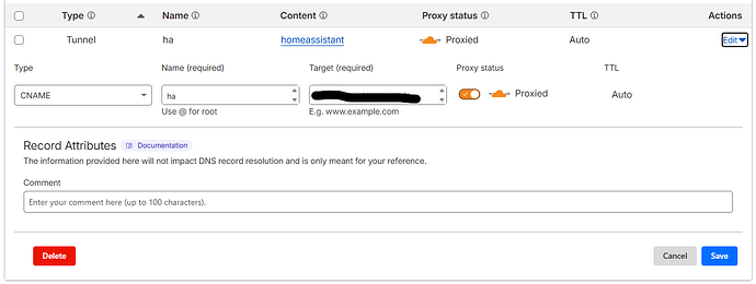

I use a Cloudflare tunnel with a custom domain to connect to my home assistant, and I can control my ha using Google Home app and also my Google Nest speaker. Sometimes can have some delay but overal works great

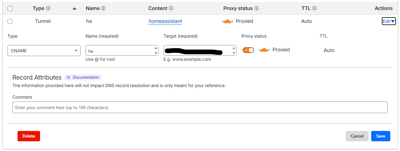

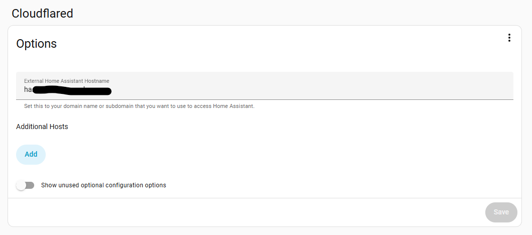

My configuration its really simple
