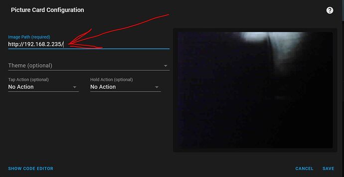

  3. the camera is impossible to insert in HA

Use Picture Glanc Card

3)

  3. try opening the URL in the PC browser / In the companion app you need to clear the cache.

    3)

  3. if it works in the normal browser it should work in HA, you are using SSL in HA?
1)
3) yes Duckdns
Duckdns is a dynamic DNS / SSL is “HTTPS” Are you opening HA with HTTPS?
