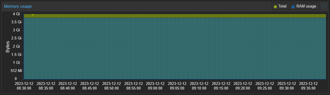

Just set up HA in a HassOS container in Proxmox. I haven’t set up any integrations or even logged in yet and it’s already using 94% of the 4GB I gave it. Is this normal?

What Proxmox reports and what HA is actually using can be widely different. You need to look at resource utilisation inside HA to get an accurate figure.
