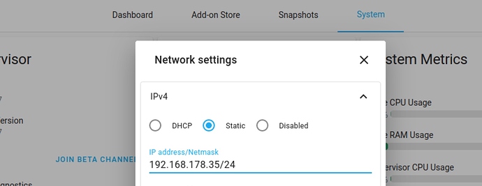

So, I’ve got a final solution that’s been working for a couple of days now:
I was following these two videos from the hookup and KPeyanski
And I just realized (after too much time, tbh) that everything was working before the nmcli con edit part…
That was messing up with the DNS and the internal network stuff.
So I just installed it normally and adding a static IP from within Hassio itself…
Also I was accessing Home Assistant through my local network, I have it installed in a server with Ubuntu.
Had the same problem. This fixed it for me, thanks!
