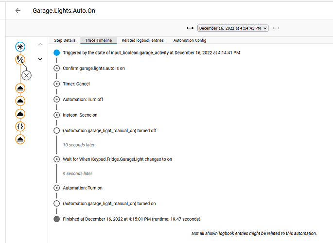

Same issue, seeing 10-15s lag on all things insteon. Going from an ISY994 integration it’s jarring:
This uses a scene (42) and a device, 2B.FE.64
Link to log: insteon.log · GitHub
Using USB PLM and the docker image of Home Assistant. USB passhtru not an issue since my zwave setup is identical (docker image with USB adapter)
