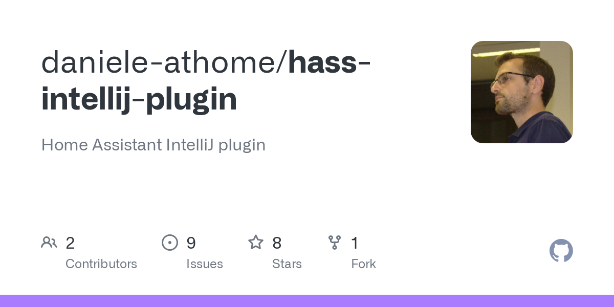

Hello there,
I write my Home Assistant configuration with IntelliJ IDEA (I know, probably overkill, but I can’t really get away from it lol) and I’ve always been frustrated by the absence of code insight features. After some time debating with myself about the time that would be wasted effort that would be required for developing such a tool, I decided to experiment with an IntelliJ plugin:
Beware that at the moment this is beta quality software, however I’ve been using it for some time now with no issues - except maybe for some minor performance issues that I’ll have to work on.
Here is a list of current features:
  • Bundled YAML schema from the awesome Visual Studio Code Extension
  • Go to definition for any locally defined script, automation, input_*, group, or shell_command
  • Find usages of any of the above
  • Access remote Home Assistant data about available services (actions) and entities to resolve references
  • Action call completion (only in action: and service: contexts)
  • Entity completion (only in entity_id: contexts)
  • Secret completion
  • Go to secret value
  • Dedicated module facet, supporting multiple Home Assistant configurations in the same project (only for IDEA)
  • Provide documentation hints for supported elements (experimental)
  • Material Design Icons completion
In order for the plugin to work in IDEA, you’ll need to add the Home Assistant facet to the module containing the yaml files. The facet requires the URL to the instance and an access token to retrieve the list of actions and entities from your Home Assistant instance.
In other JetBrains IDEs (e.g. PyCharm), a per-project settings section is available in Settings > Tools > Home Assistant.
The plugin is currently on the marketplace stable channel:
If you want to use the latest master, you’ll have to build it manually - fortunately JetBrains made that very easy:
# beware of the submodules!! Use 'git clone --recursive'
./gradlew buildPlugin
You will find a zip file in build/distributions that you can install in IntelliJ using the “Install Plugin from Disk” function.
As I said, this is beta quality software at this time - also this is my first IntelliJ plugin and I’m a bit rusty on Kotlin - please be kind and give feedback if you want this plugin to improve :pray:
