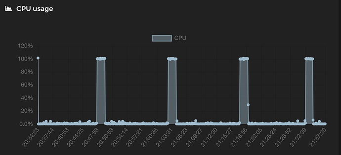

It looks like my instance of home-assistant is jumping to 100% CPU usage every 10 minutes or so and lasts a couple minutes. I’m new to home-assistant so it’s possible I’m missing something obvious but I’m not sure where to start troubleshooting.

Disable one addon at a time and review the CPU usage. I’d say it the Nest stream is the CPU hog, but you definitely have issues with both.
The glances addon can show CPU utilization per addon and process. Open it and press z and c to show processes and sort by CPU respectively.
Cameras can be pretty heavy on CPU, if you do some object identifying on the streams.
Try to disable those first.
Thanks all, turns out Nest was causing issues. Will continue looking into a solution but this was in fact isolated to a single plugin.
