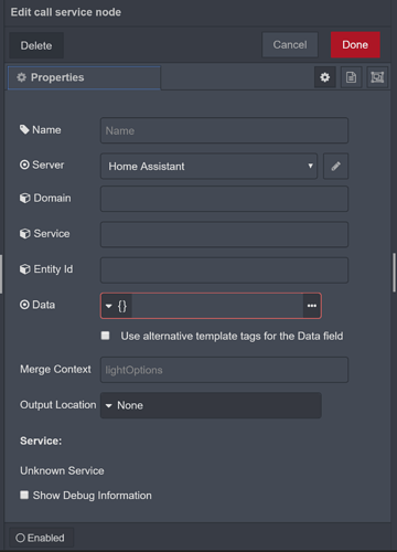

If you are setting everything in the payload, you don’t need to fill out anything in the call service node except for the server.
I added a new call service with only the server set to Home Assistant and I still receive the same error. I also tried going back to just an inject and a call service to set the high and low and get the same error.
