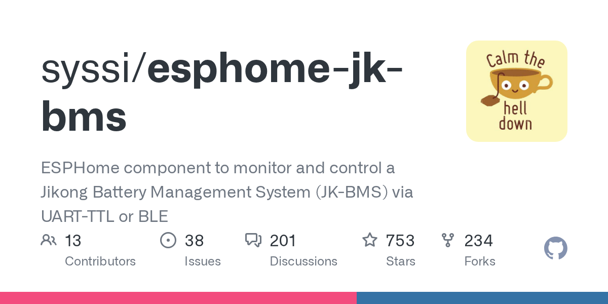

With this
Designed tk do exactly what you want

Then you ALSO need a cheap esp32. You load the custom components into an esphome sketch (from home assistant) and then place the esp32 next. To the device it proxy for the HA box.
