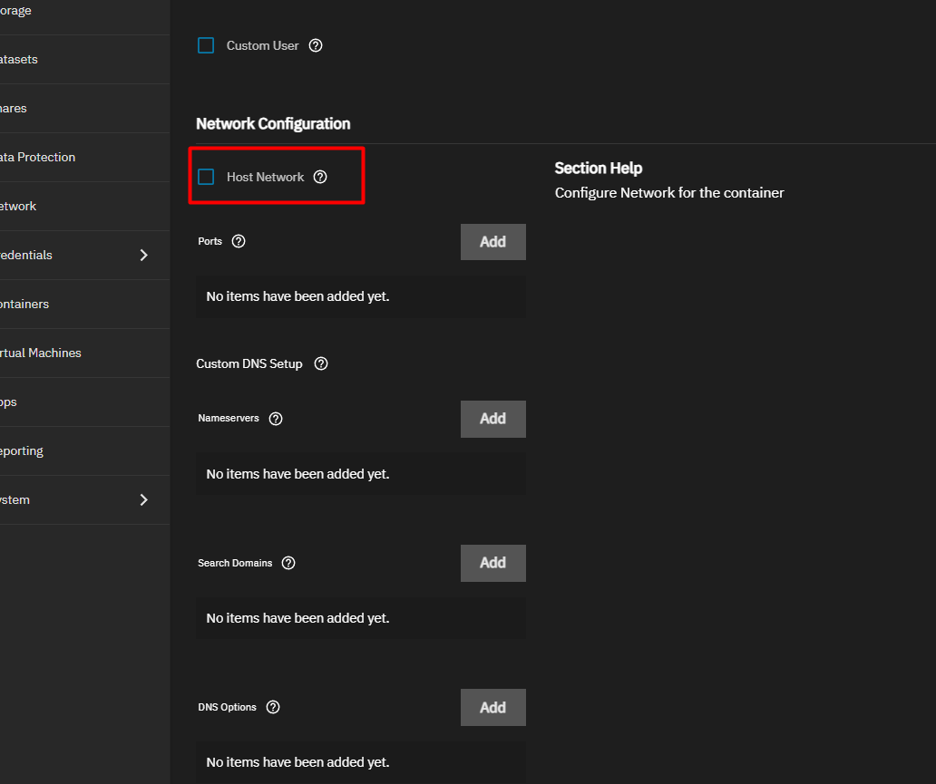

Normally, the fix would be to enable “Host network mode”, which exposes the container directly to the LAN.
However:
  • The official TrueNAS UI doesn’t provide a “Host Network” checkbox for built-in apps.
    I found that this option does exist for Custom Apps, so I converted Home Assistant into a Custom App to gain access to its YAML configuration.
    Unfortunately, even after conversion, I couldn’t make it work — I tried adding network_mode: host manually in the YAML under the home-assistant service, but TrueNAS either ignored it or refused to deploy the app.

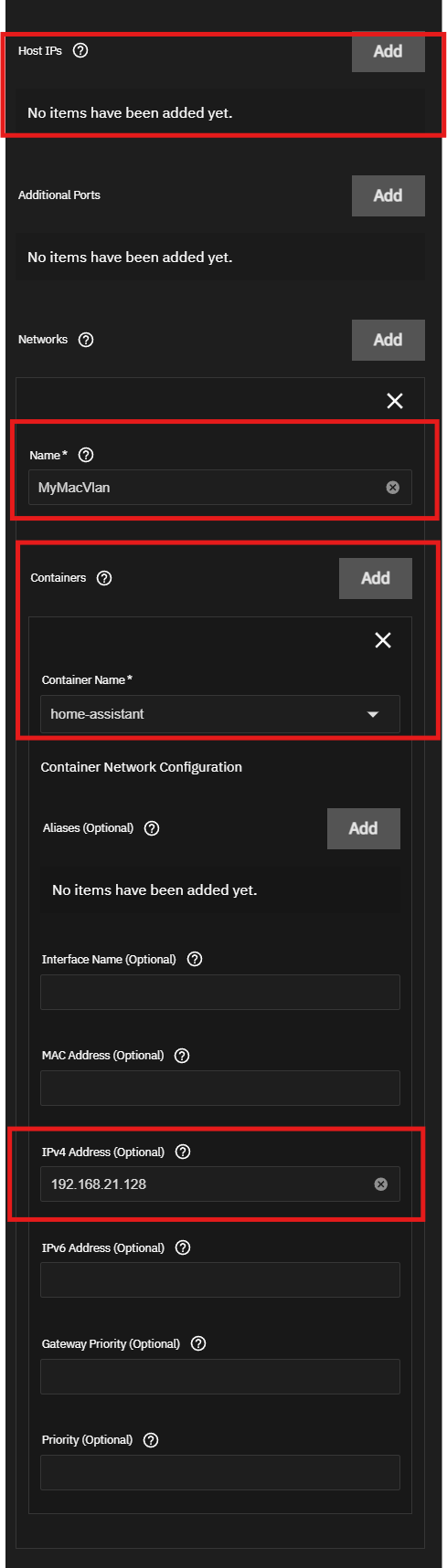

I got the Truenas native Home Assistant working and auto discovering devices on my network!
Quick Steps.
  1. Setup a MacVlan for your system.
  2. Do not use the Host IPs. Use the Networks area.
  3. mDNS must be working on your network.
Longer steps:
MacVlan Setup.
  1. For MacVlan setup follow along with with video. He will walk you through setting up the two parts of the MacVlan setup using Portainer.
    https://www.youtube.com/watch?v=4741-YR31fM
Once the MacVlan is setup, you can then add it to your Home Assistant config.
  1. Click on your Home Assistant in Truenas and Click Edit.
  2. Delete the Host IPs entry
  3. Add a Network (Screenshot at bottom of page)
    a. Set the Name to the MacVlan name you created in portainer.
    b. Select your Home Assistant container
    c. Set your IP address.
Make sure mDNS is working on your network. If you are using default settings for your network, then everything should work fine.
Hope this helps someone.
