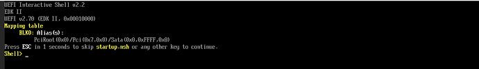

Same problem here. Looking at the console in proxmox it only boots into UFI Shell.
Used the information from that thread to resolve my issue, linked here incase you guys run into the same troubles.
