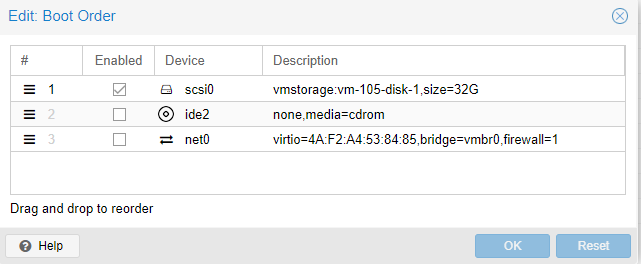

Very important: You need to explicitly set the boot order because the new disk is not included by default, therefore it will not boot:
