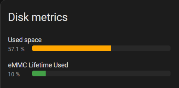

The current storage UI shows used space, but doesnt give much info past that:
What would be useful is to show the used storage from:

The addition of the storage drive’s capacity when viewing under config/storage.
Currently, it only shows the usage as a percentage but does not show the capacity used or total.
Going back one page to config the remaining capacity is shown in a non-percent form ie GB.
