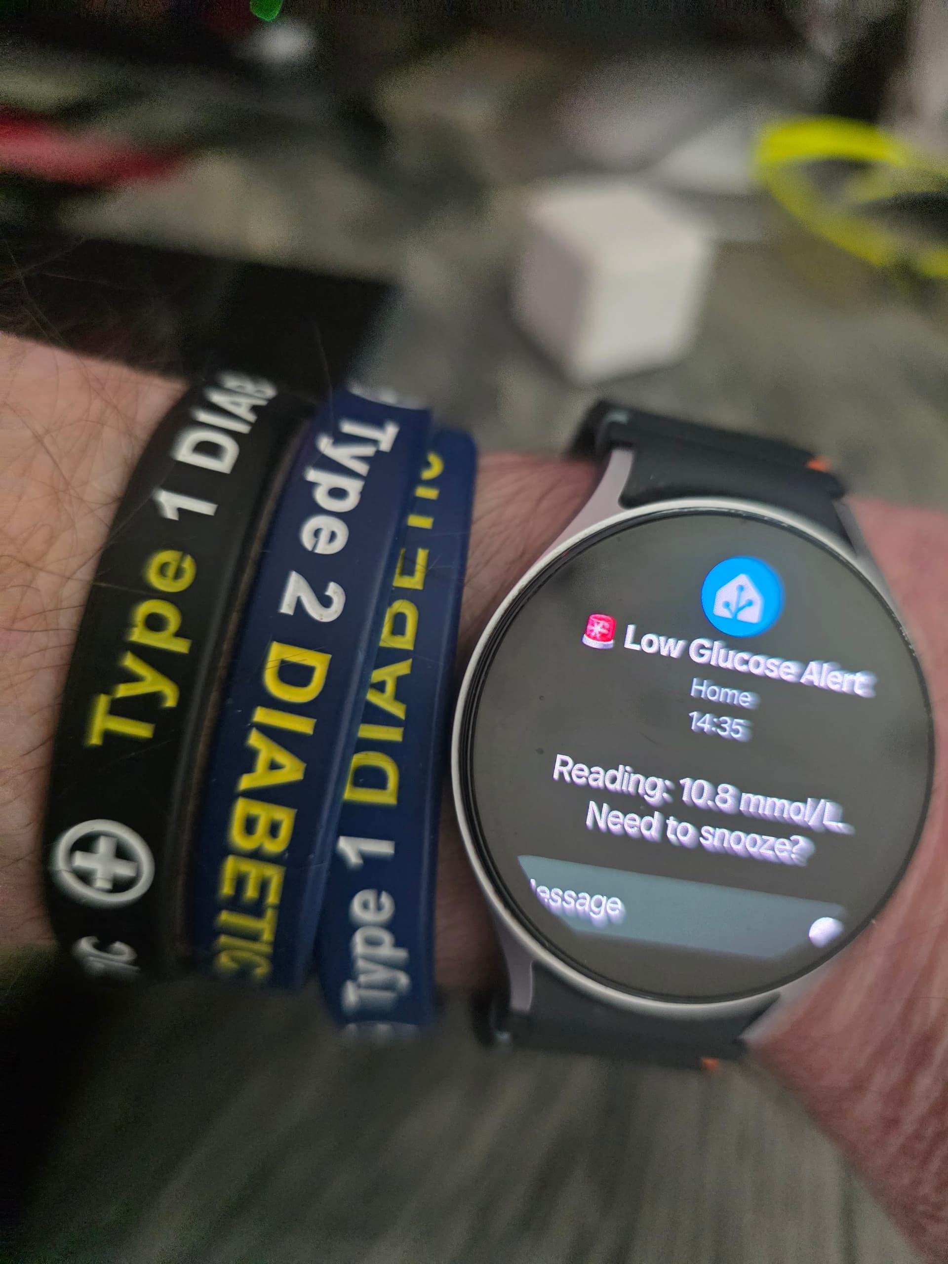

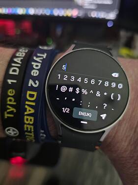

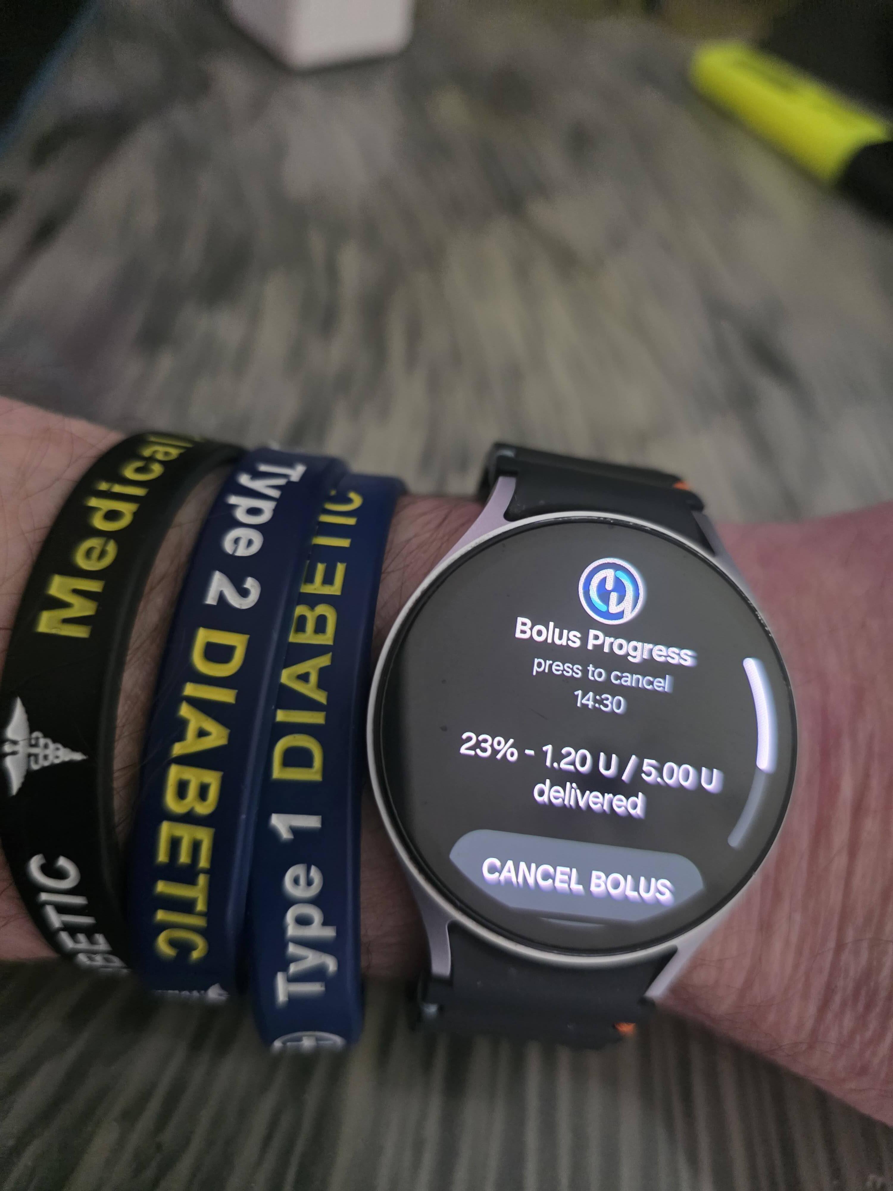

This is me giving myself insulin to get down from my high and a test alert for me to show you its possible to do it from your watch and mobile too snooze it, and what ever time you give it, you will get a countdown Snooze timer.

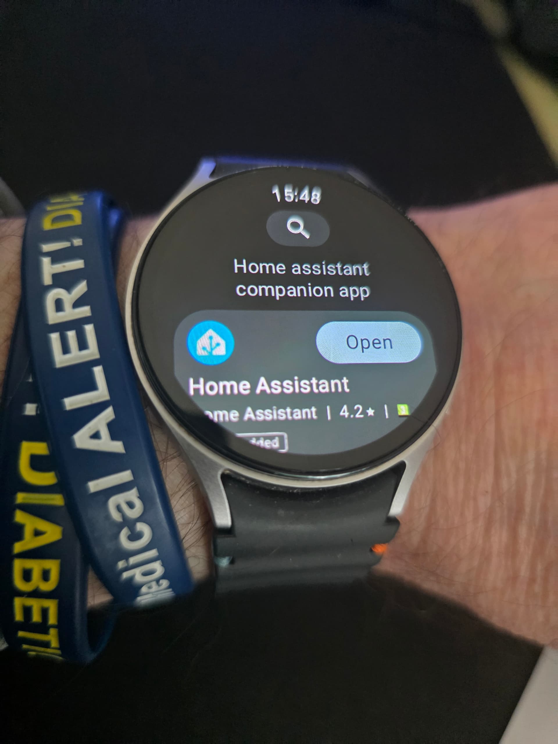

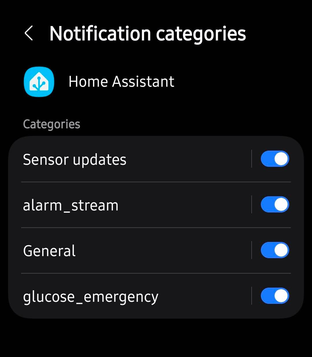

You just need to install Home Assistant Companion App onto your Galaxy watch 7 from the play store and allow permissions and notifications on your mobile!
And the time I added!

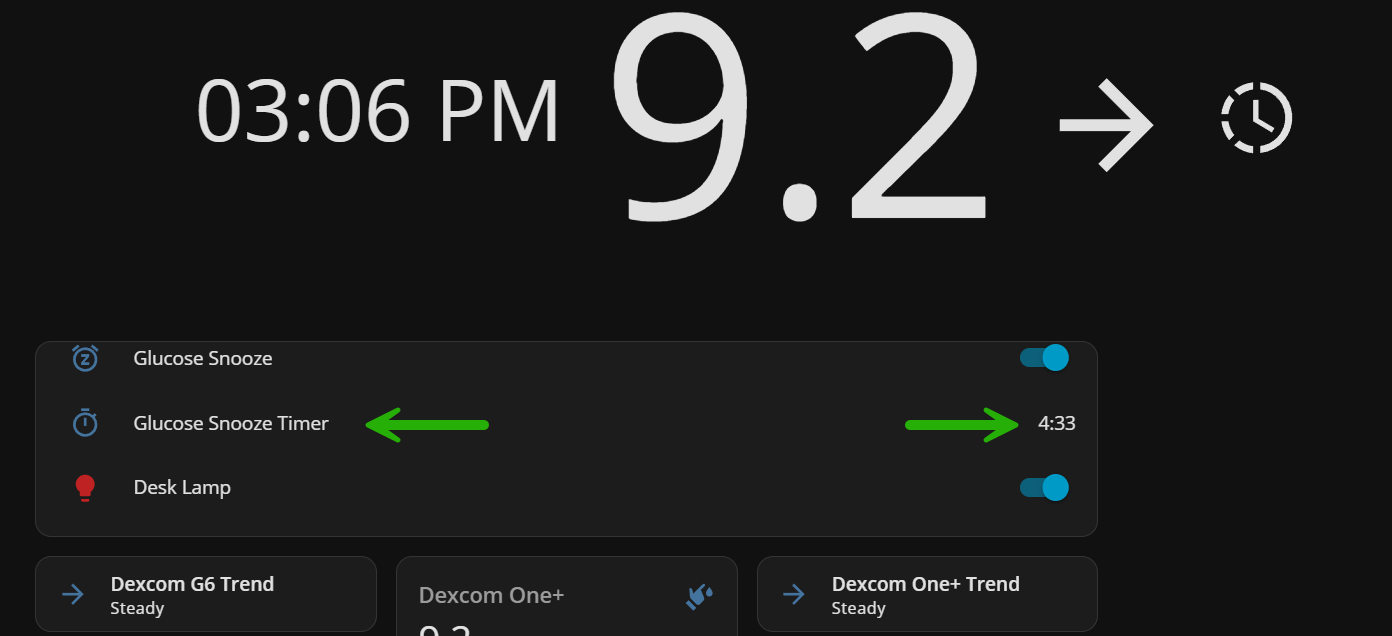

And the countdown you can see with an Entity Card on your front end Dashboard.

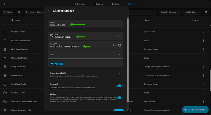

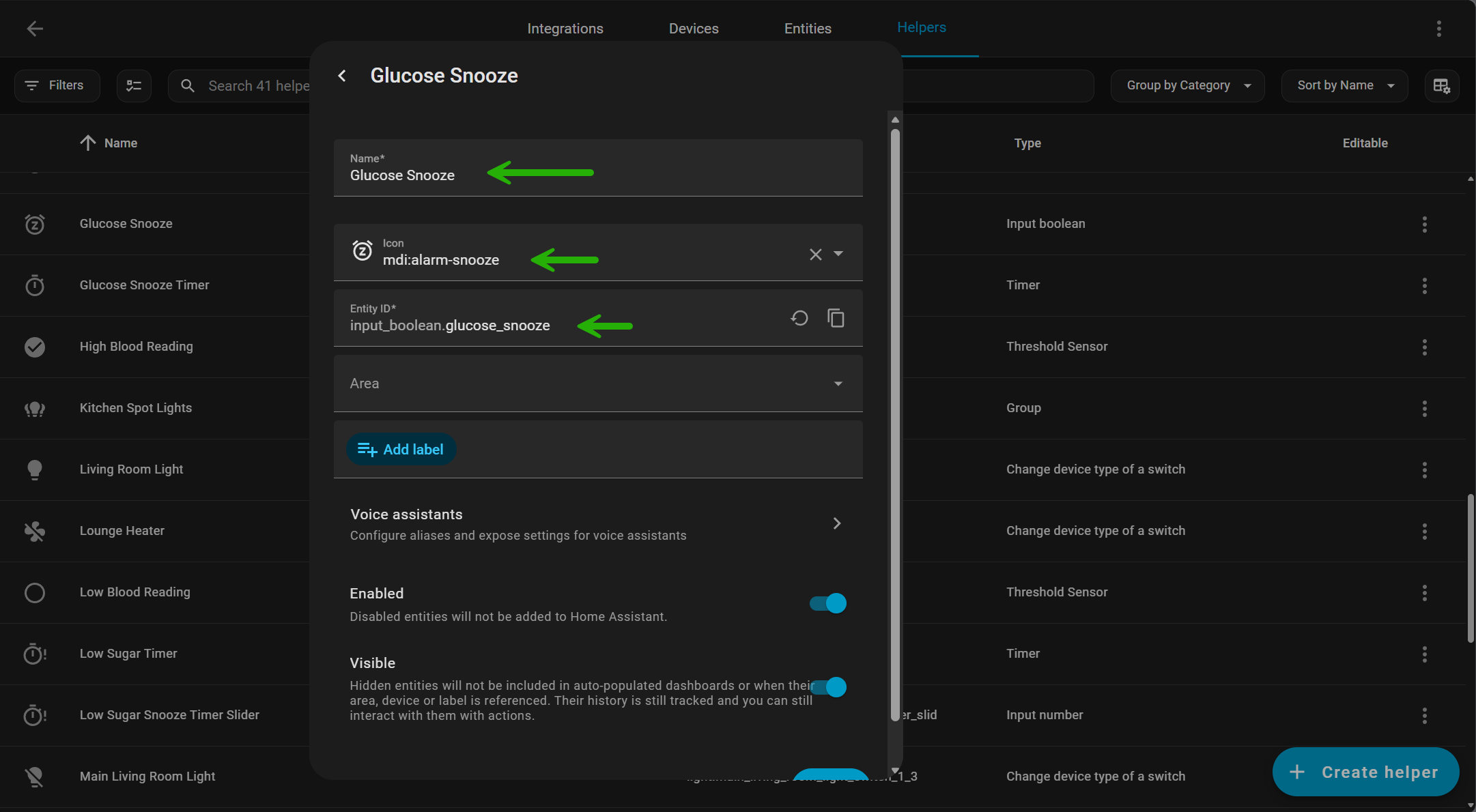

Helper:
Create a “Snooze” Helper
To handle the 20-minute delay, we need a “switch” that tells the automation to be quiet.
  1. Go to Settings > Devices & Services > Helpers.
  2. Click Create Helper > Input Boolean.
  3. Name it Glucose Snooze.
    (Entity ID:
    input_boolean.glucose_alarm_snooze).
