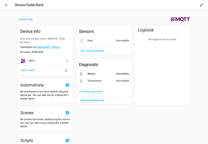

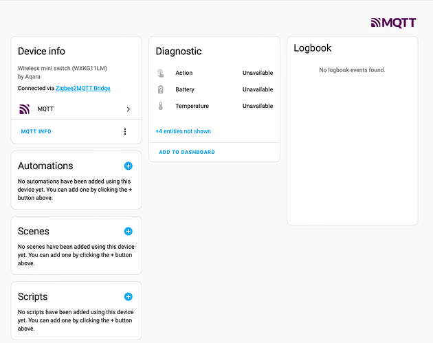

Home Assistant shows all ~100 devices as unavailable.
Any ideas?
