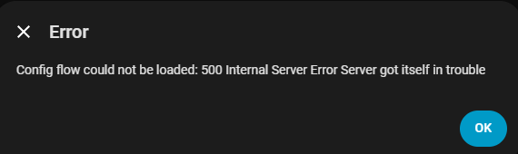

When I configure the integration by providing cloud id, secret, uid and username (I assume this is the username for tuya developer account). I get a message saying the integration was configured successfully. However the devices do not show up. When I try to configure the integration once again, I get this error message:

There seems to be a compatibility issue with the version of HA and localtuya. I followed the instructions provided by vjmaz
(Config flow could not be loaded: 500 Internal Server Error Server got itself in trouble · Issue #2130 · rospogrigio/localtuya · GitHub)
This resolved by localtuya error.
