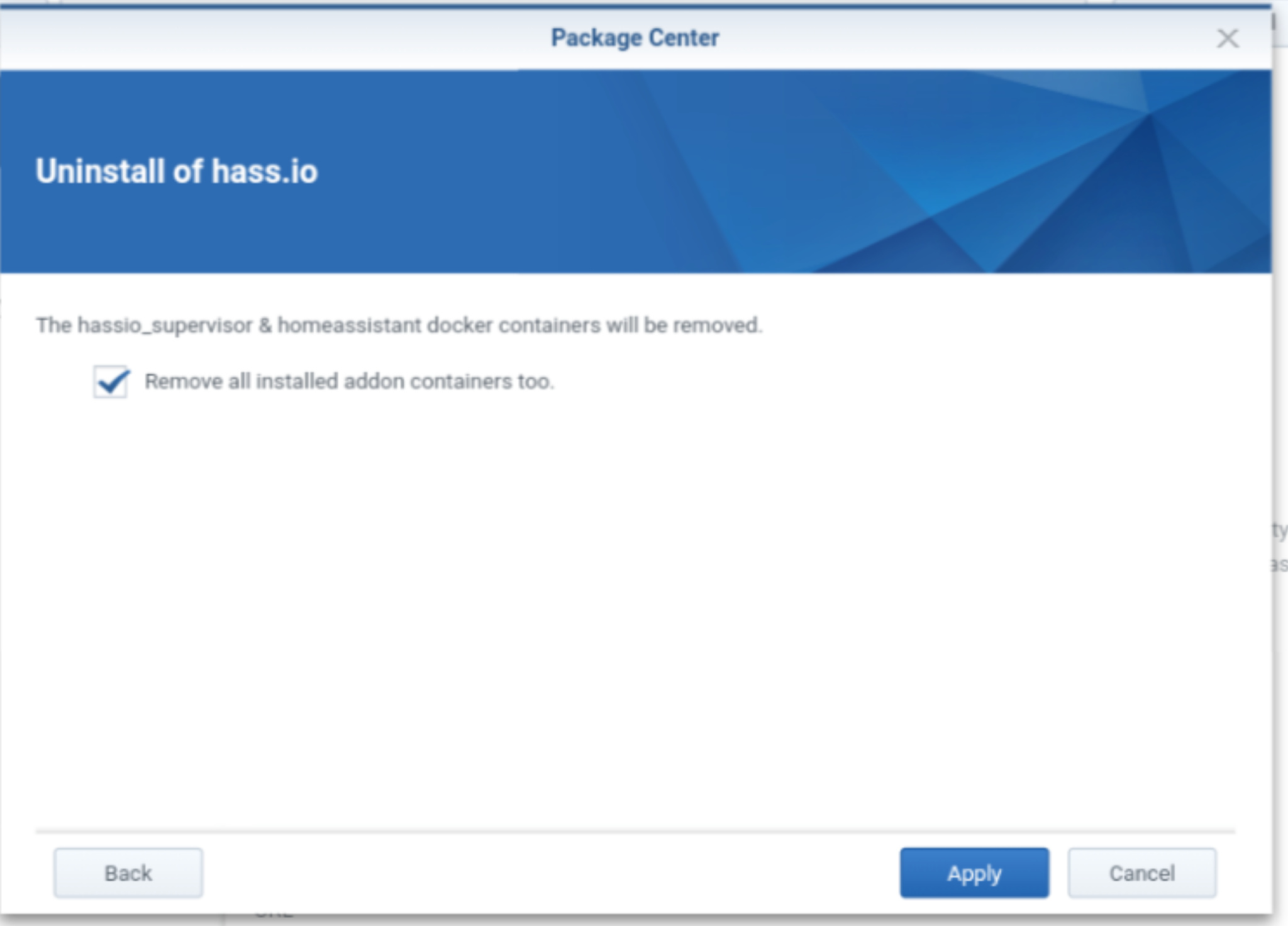

The Uninstaller will remove the containers and networks (if the box is ticked).
You only need to remove the hassio folder.
