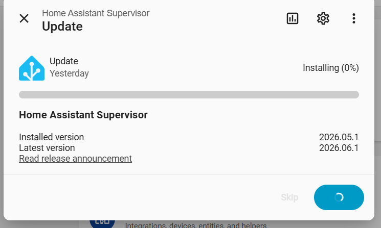

Home assistant supervisor stuck at install status
Home assistant supervisor stuck at installing status, even after I restart the home assistant.
How to solve this?
