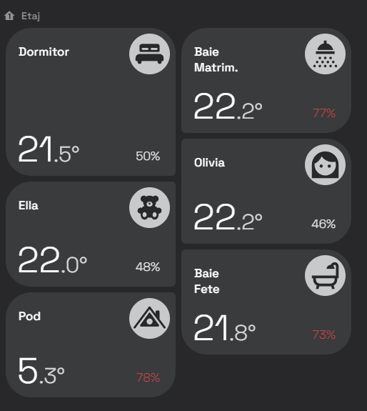

I have tried various things (many suggested by ChatGPT) to reduce the load in the frontend (where I have dahsboards using button-card heavily with javascript processing, lots of entities displaying informaiton, and so onā¦) to move logic from the forntend to the backend in template sensors. I still get these log messages and sometimes HA slows down.
