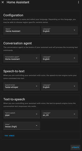

Since the documentation for voice PE all seems to assume you’re running HAOS in some form pressed on and made sure to have the wyoming setup finished as well, thinking something could be missing there. So i have wyoming with piper, whisper and openwakeword set up. In Settings → Voice Assistants I have a voice assistant set up using my local piper/whisper and that works fine when interacting with it through the web ui. Still, after that being set up I get the same error when trying to set up the voice PE. What am I missing?
Error:
Voice Assistant config:
