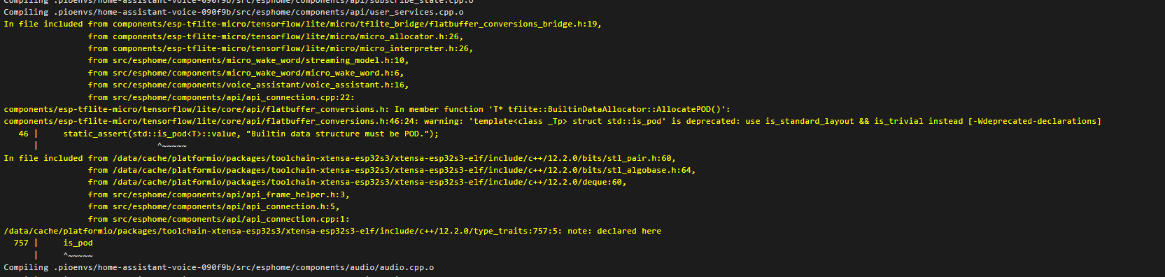

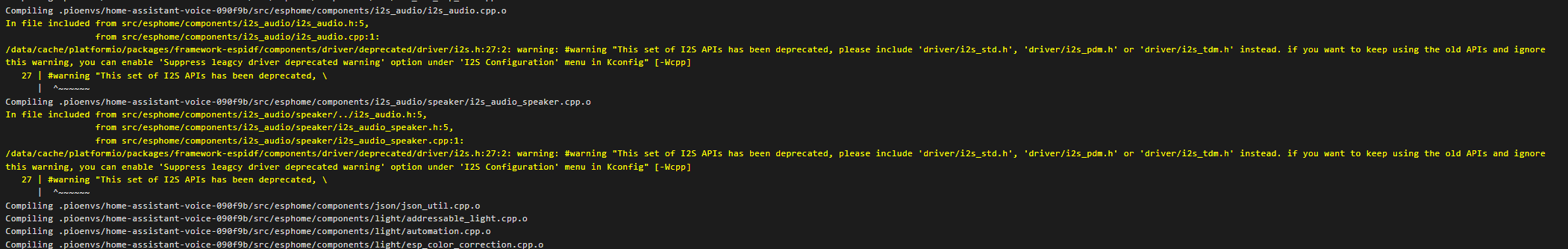

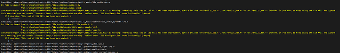

also ge these warnings when using “take control” and install:
and many other warnings.
