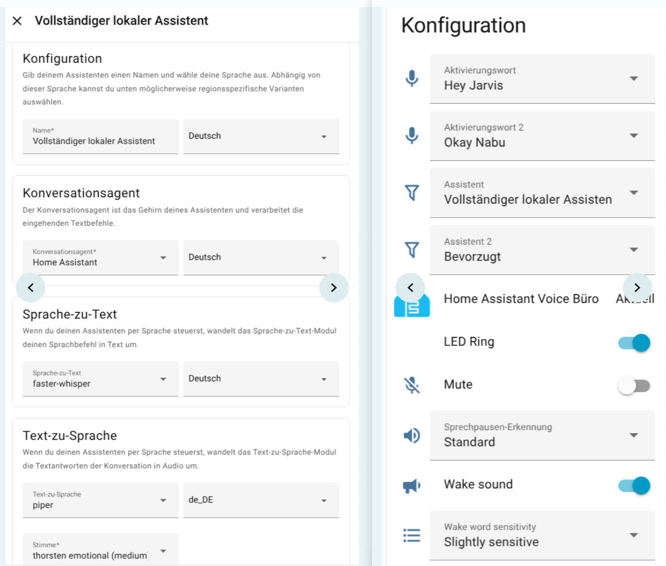

I found those entries. I speak German and it looks like that it tried to hear English.
I am pretty sure that everything is set to German. Any ideas?

faster-whisper is set to German and at the moment my only option. Could I change this?

you have 2 wake word configured and it look like 2 different Voice Assistants set. Are both Voice Assistants set for german (de)?

You launched the add-on with default settings (auto) and are using Parakeet v3 (a multilingual model without explicit language specification). Change the engine to faster-whisper.
Thanks @Jowe1
