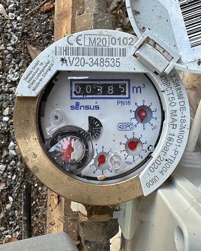

I integrated through ESPHome a proximity sensor using a NodeMCU board following this guide:
[Build a cheap water usage sensor using ESPhome and a proximity sensor - PieterBrinkman.com]
Everything seams work fine, data are updated every 6s but the measure is totally out of scale as you can see in photos. More than 1M liters a day are too many for my house ![]()
Can you help me figuring out where is the problem?
