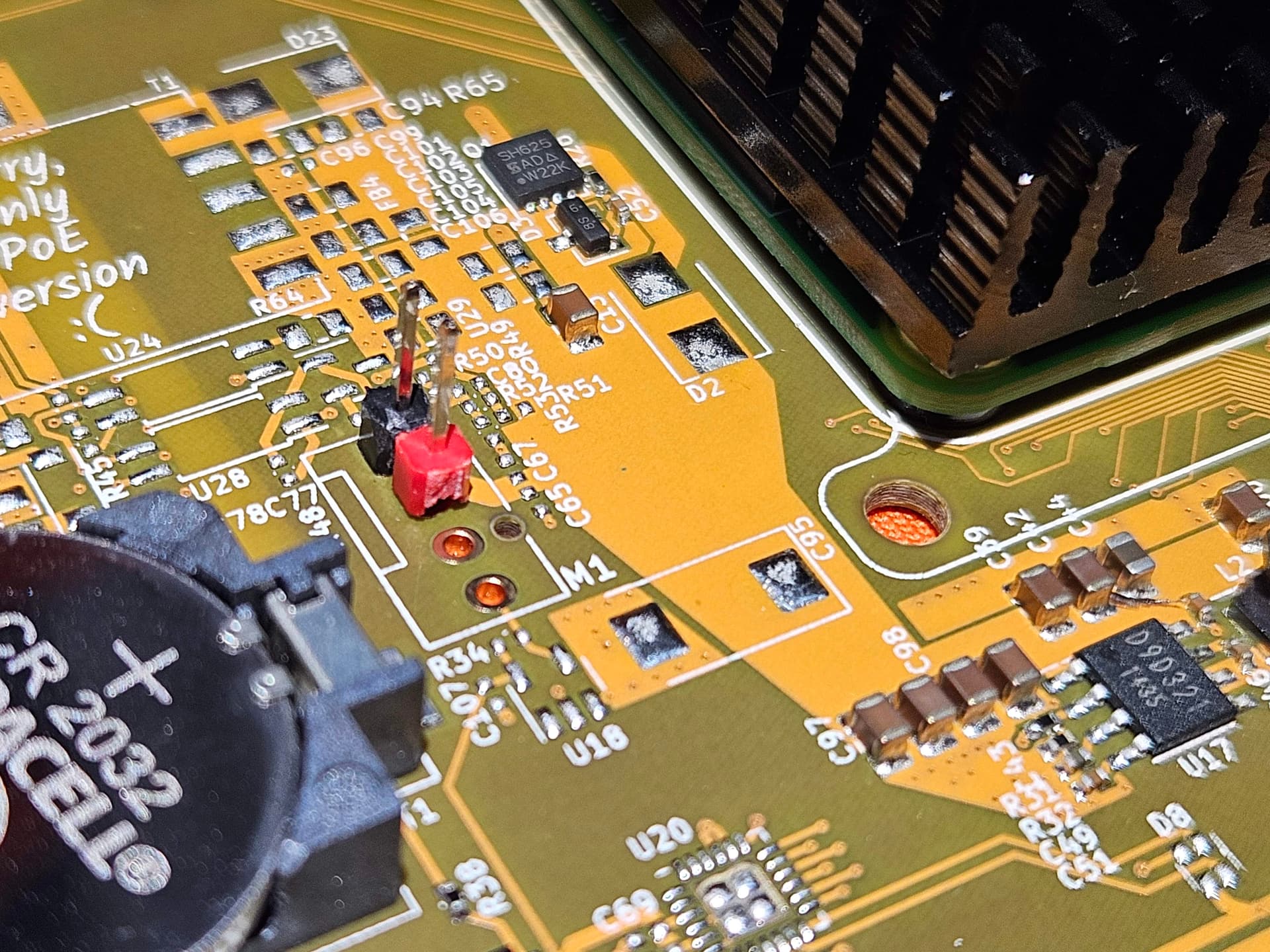

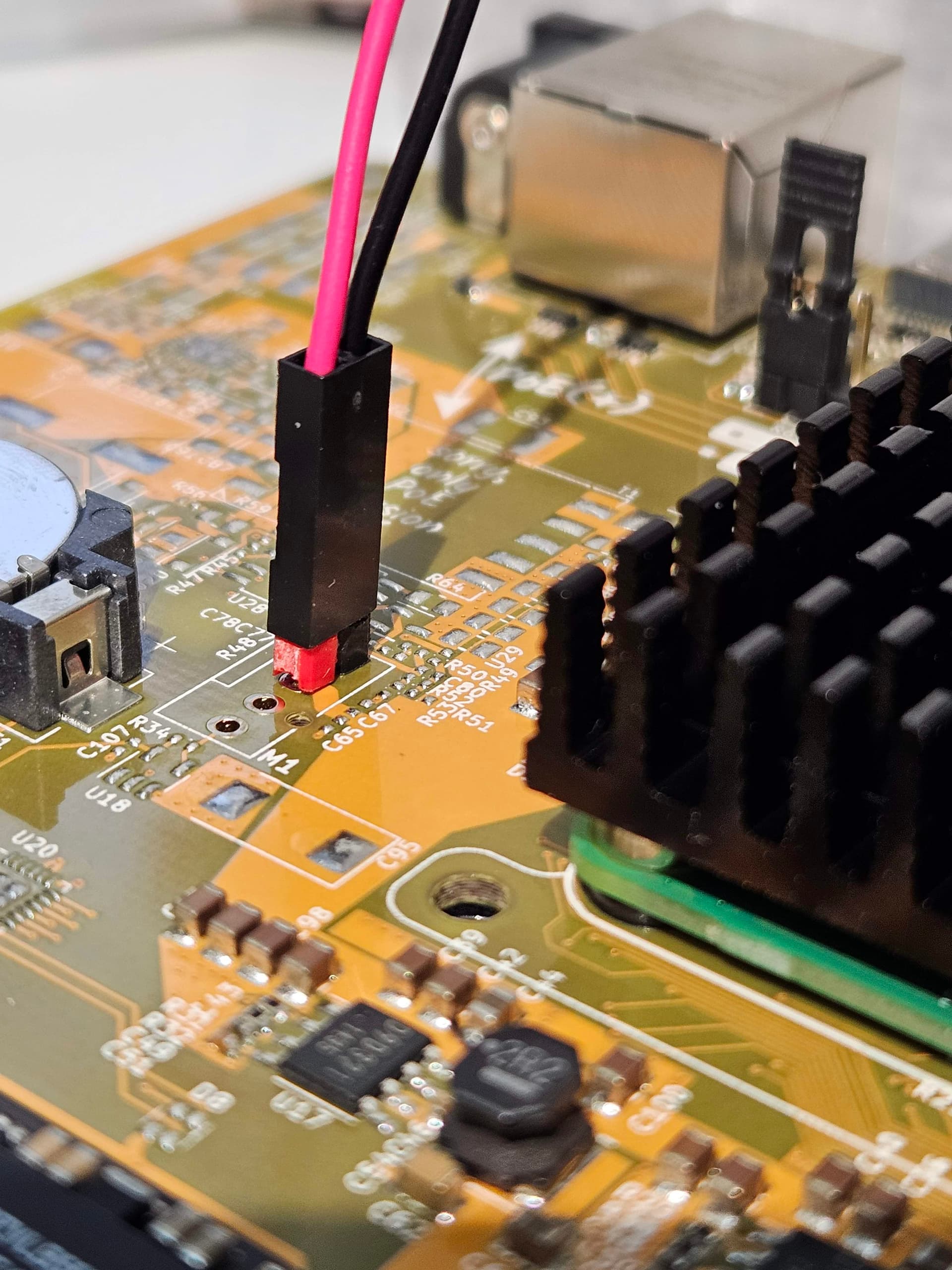

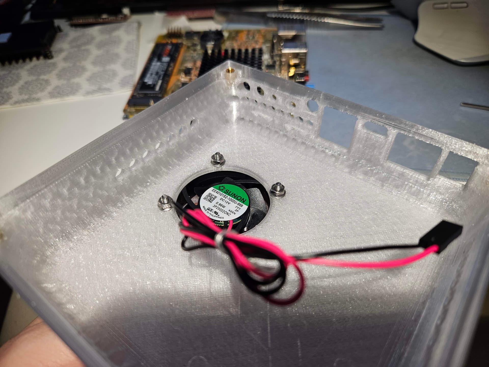

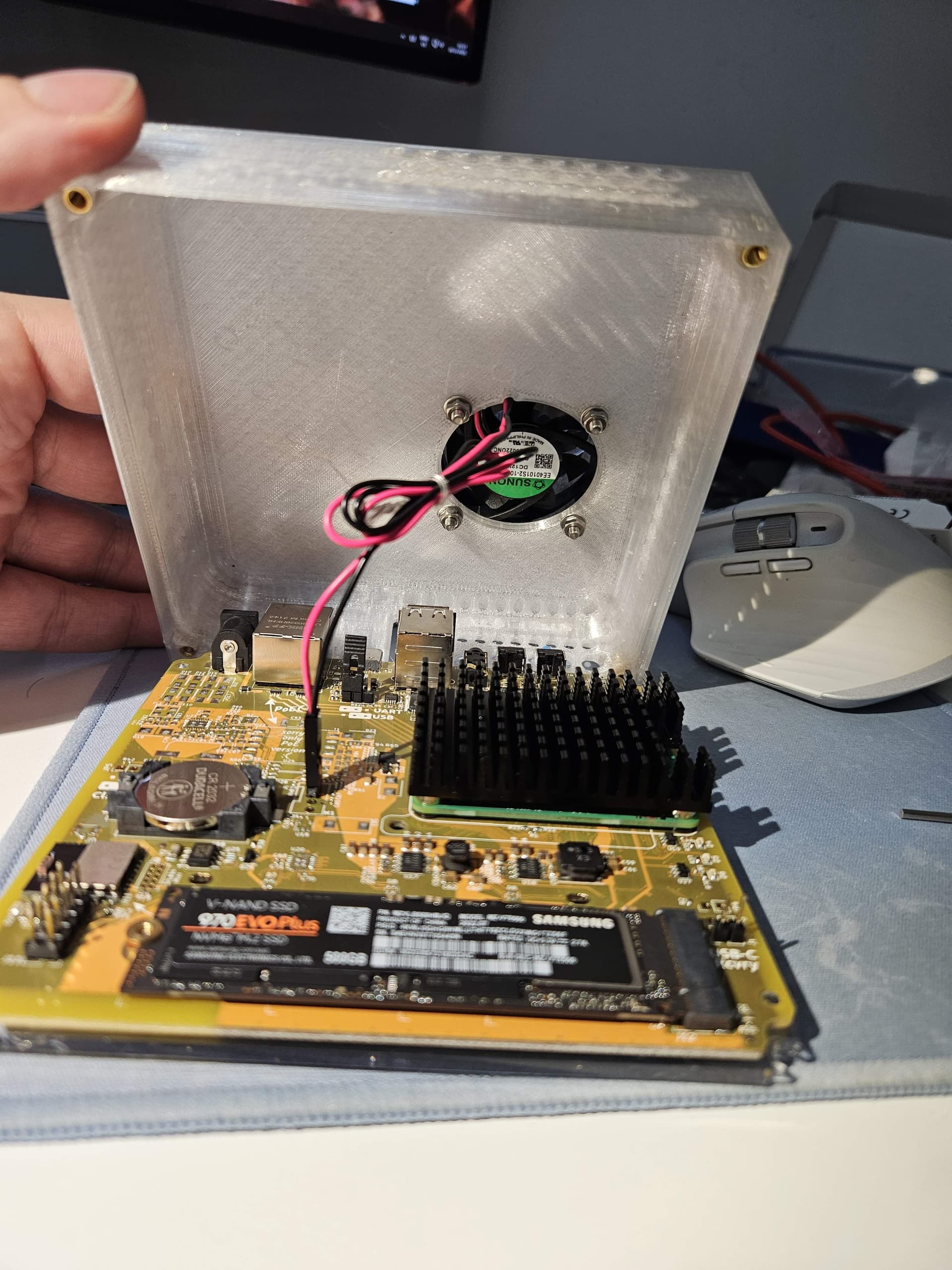

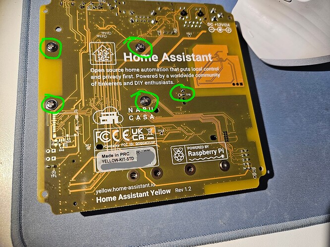

  • Found (on the public schematics & pcb layouts) a 12V pad on the PCB (and a GND)
  • soldered a small connector

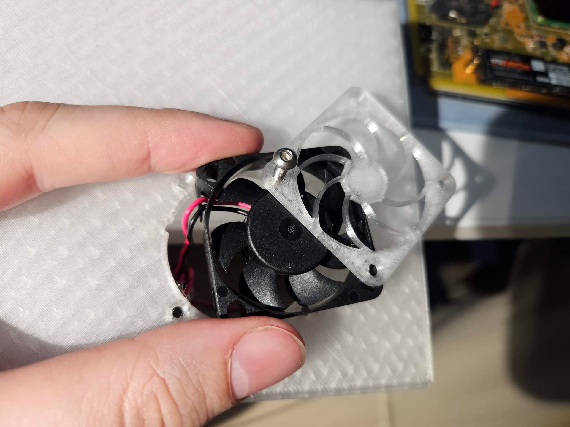

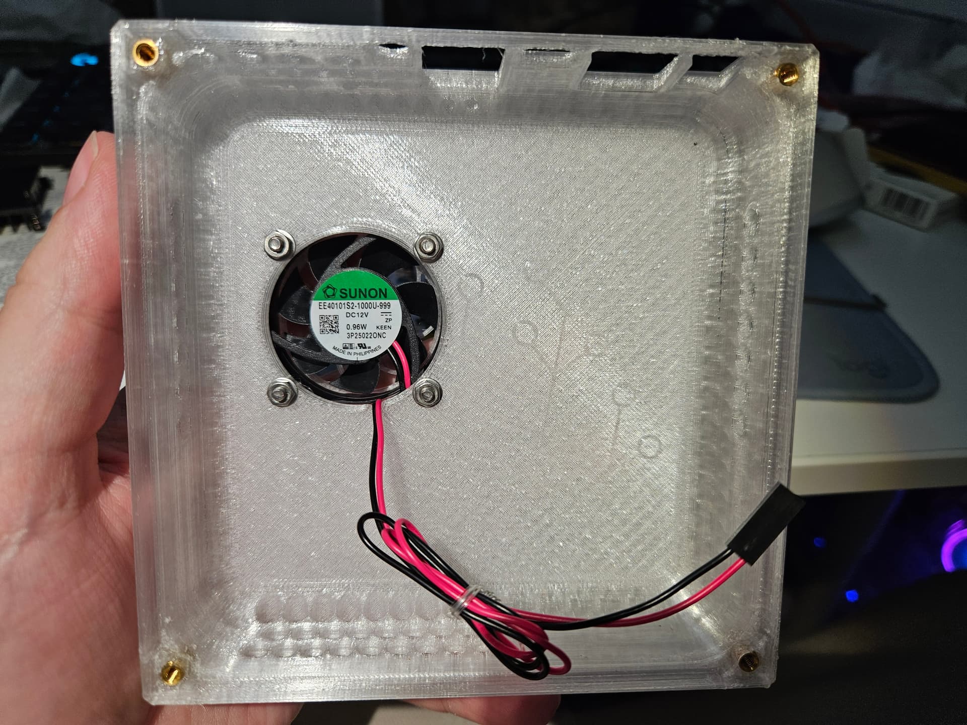

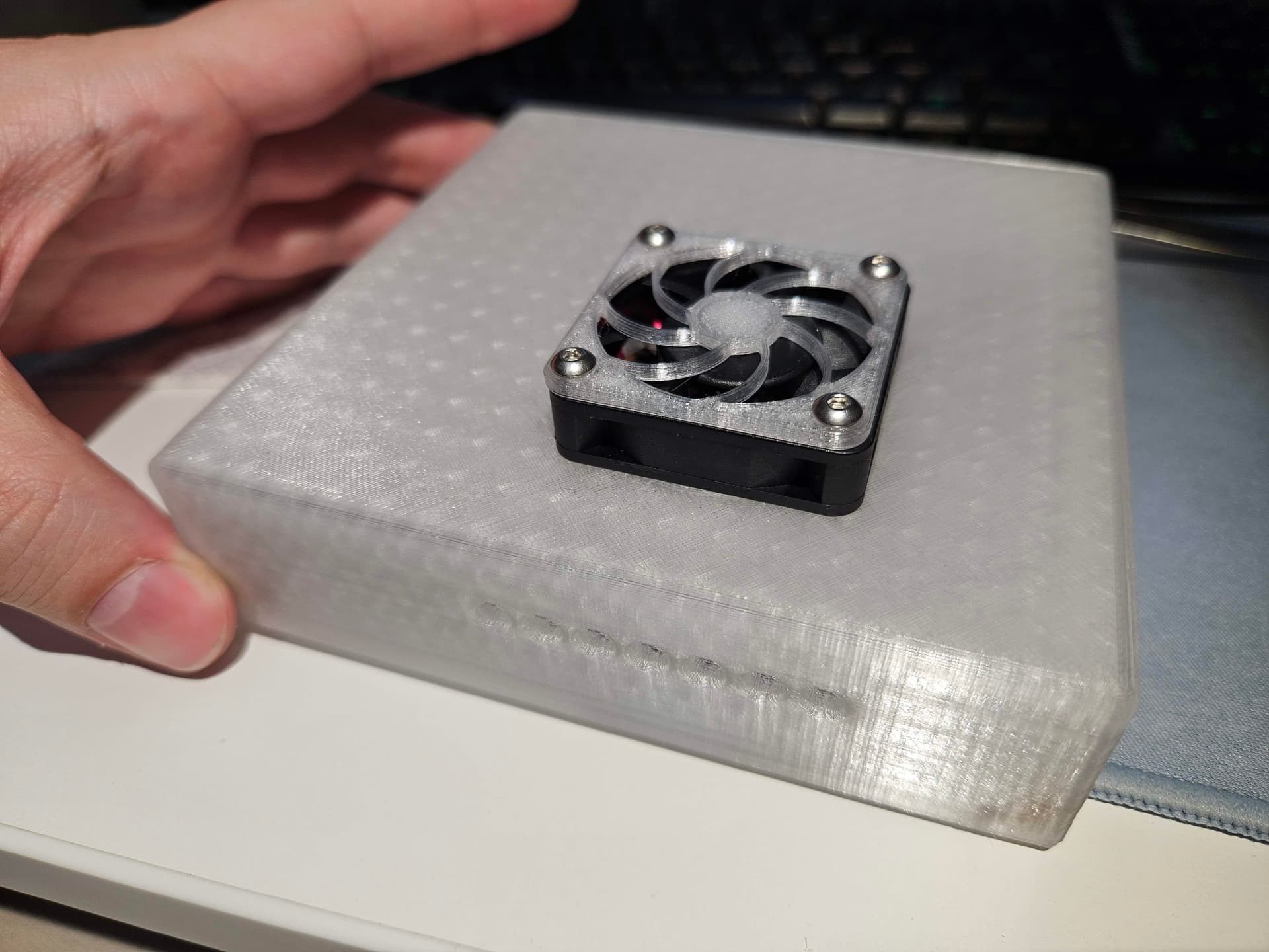

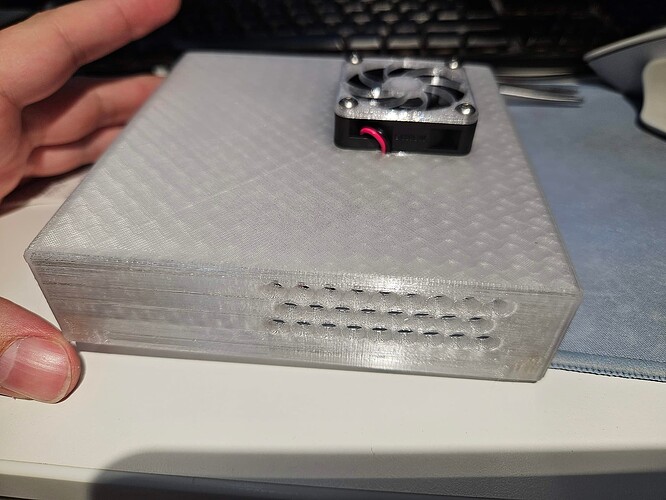

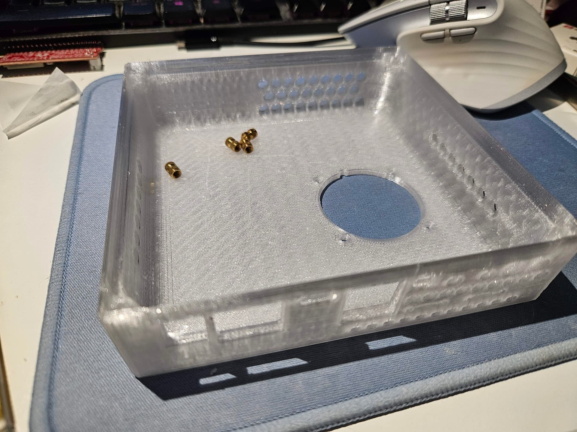

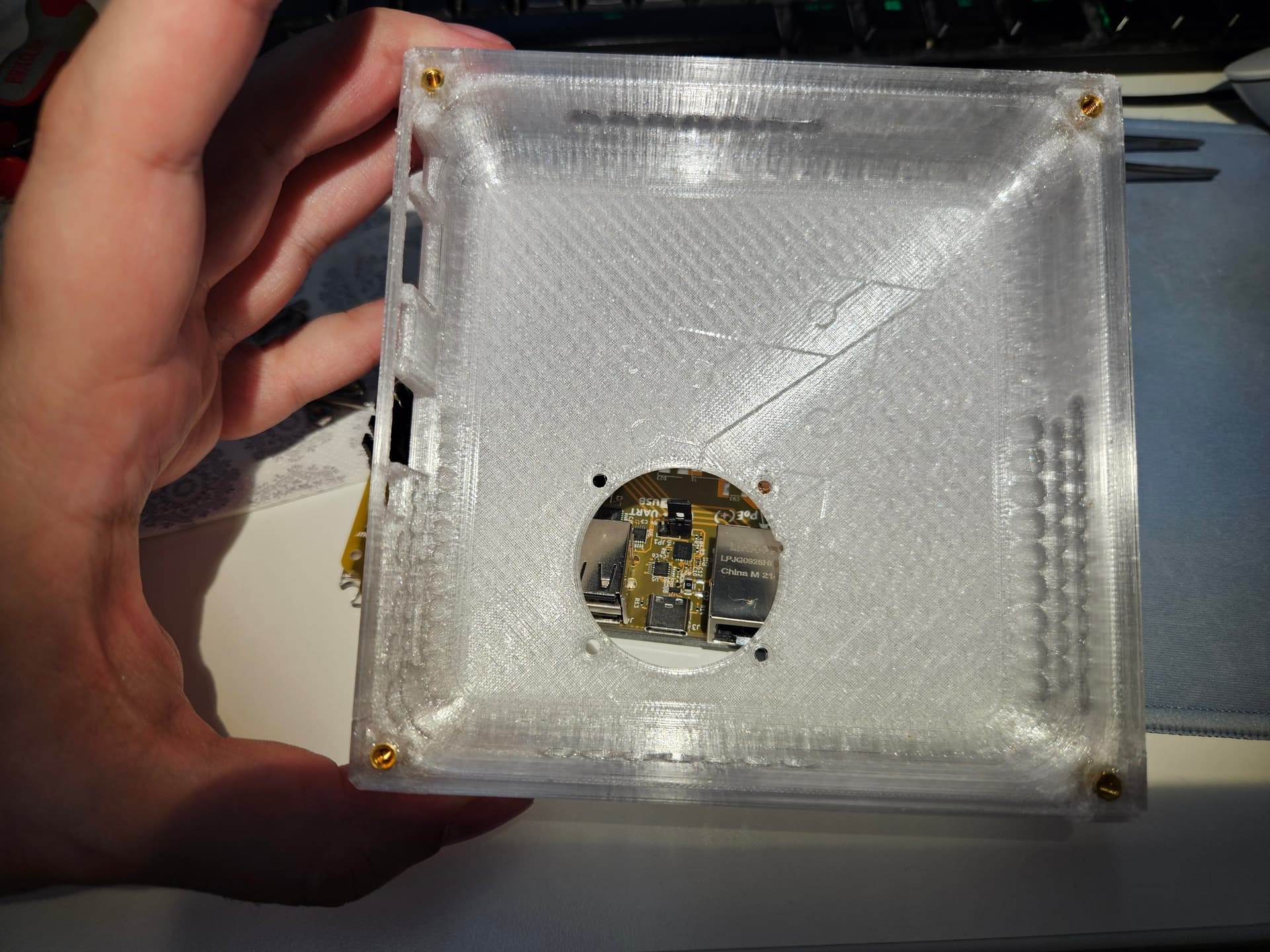

  • imported and adapted the case from Home Assistant Yellow Enclosure by Home Assistant | Download free STL model | Printables.com (which was already adapted a little bit for easier printing) to support a cooler and to have air-holes for air-out

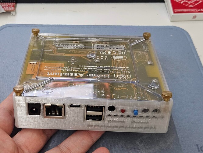

  • I 3D printed the top case (with a semi-transparent PETG material to be able to still see the LEDs inside) , added also the heat-set threaded inserts

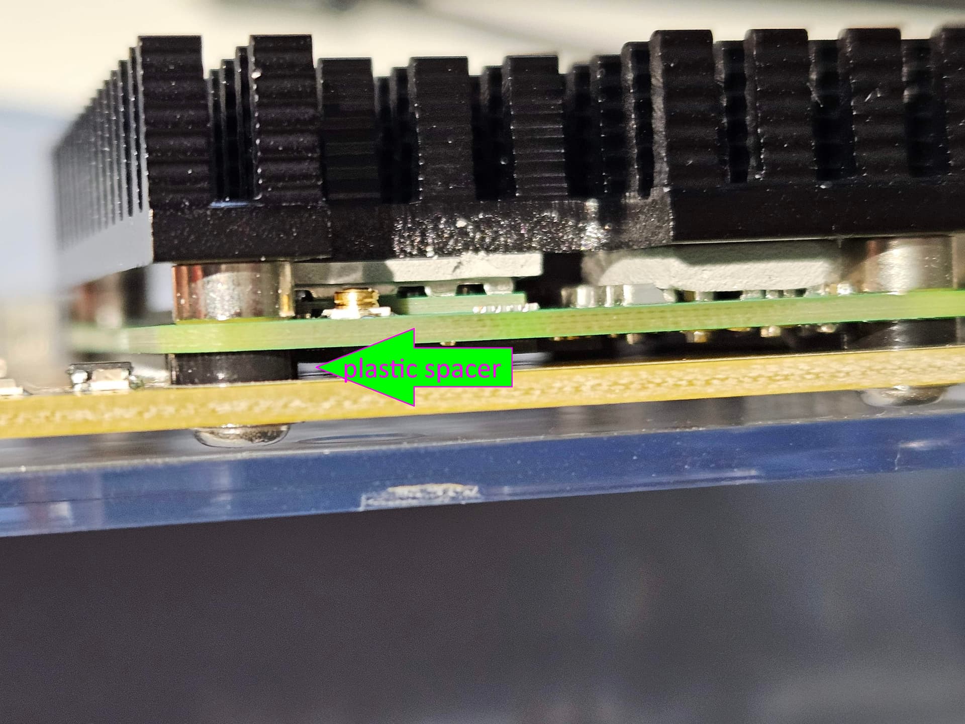

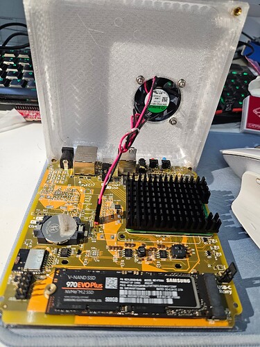

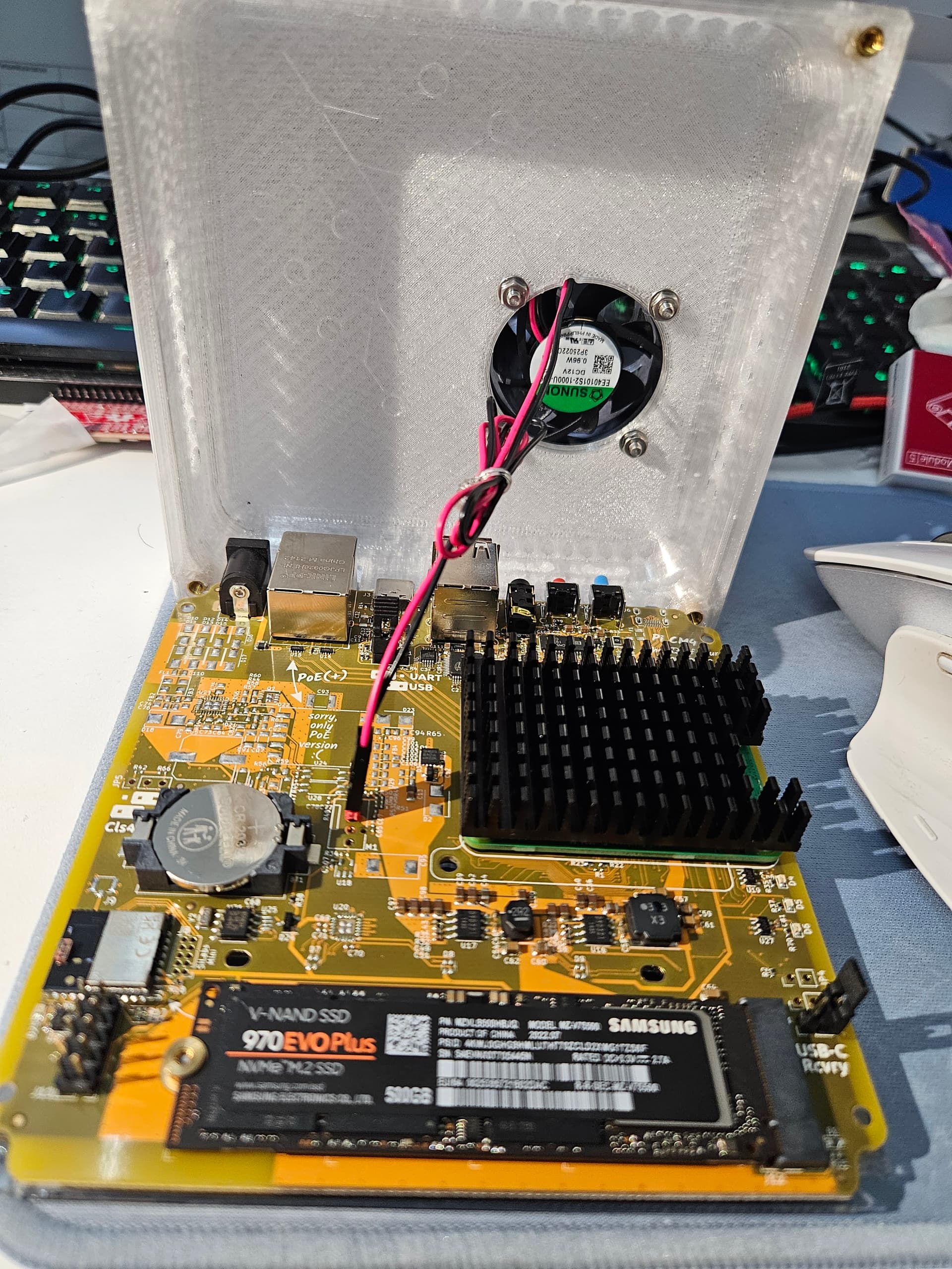

  • I used the rPi radiator “COMPUTE MODULE 5 PASSIVE COOLER RASPBERRY PI”, which came with thermal pads already applied, and I used the screws + plastic spacers included in that box
The rest you can see in the pictures.

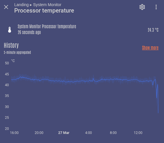

The most important for me: It works well ! and … temperatures dropped by ~20 deg :slight_smile:
                                CM4  ->   CM5 with fan
usually:                      52°C   ->    31°C
esphome compile max temp:     67°C   ->    44°C

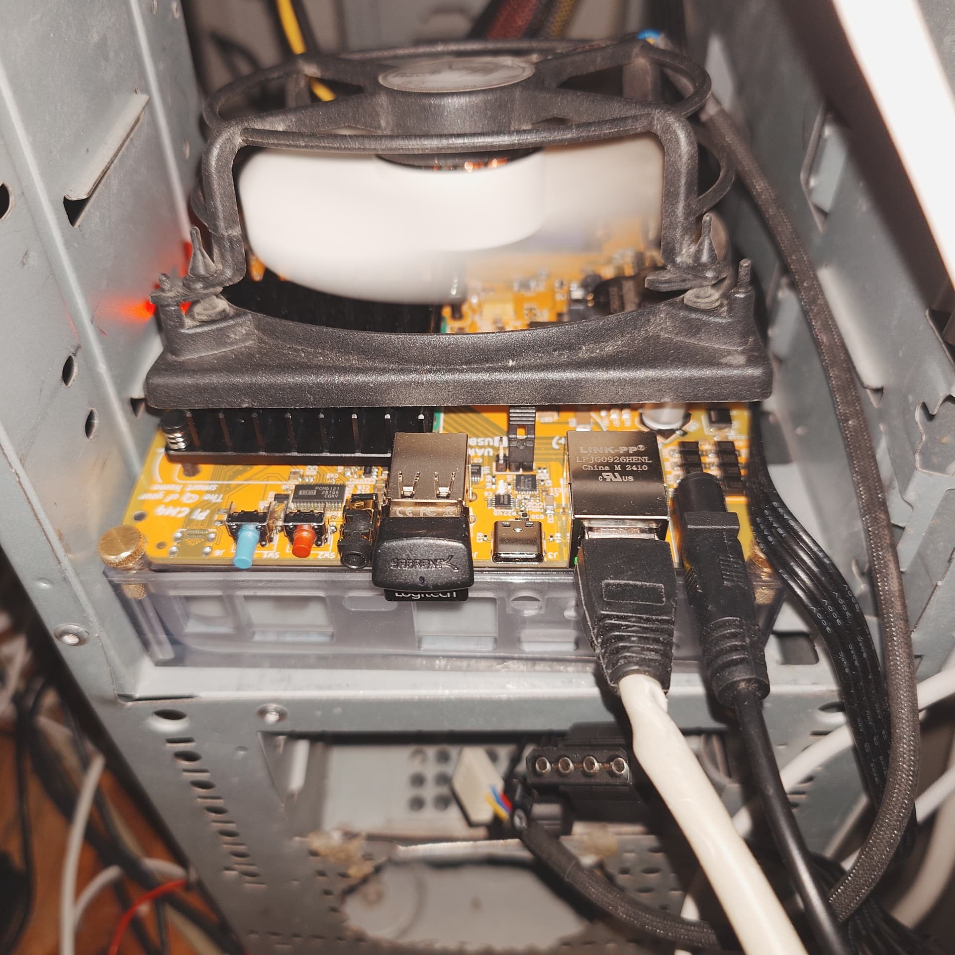

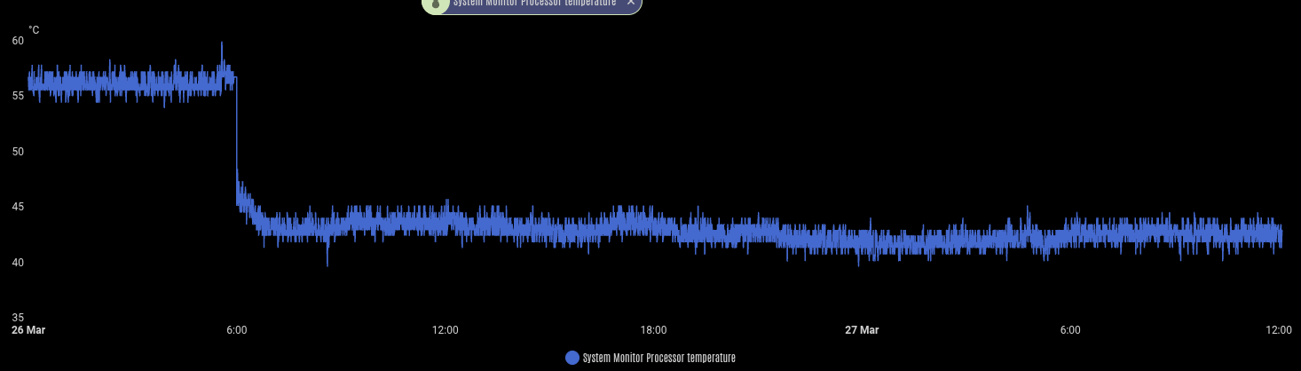

I took the case lid off and turned it upside down so the heat-sink is touching my old PC case (it rests on the heat-sink as it’s the tallest component), where I keep it. You can see the difference it made, when I did this. Yes I know it’s not safe but it fulfills the purpose until I can make it safer/or it goes pop :wink:.
Found an old CPU fan and as I have a powersuppply in that battered case I hooked it up to a molex. Must be the coolest HA Yellow CM5 out there! :sunglasses:
