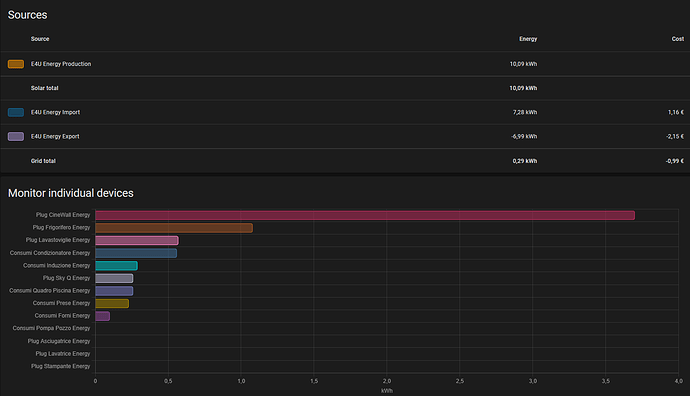

My actual situation is like this (i’m using shelly official :slight_smile: )
I don’t know but it seems somethingn wrong.
Thank you so much.
Regards,
Alessandro
It tracks the sensors you are feeding it with (production, import, export) but you can also add “individual devices” (shelly plugs, EMs, or whatever you have) so you can determine which devices contribute to consumption and how. Check my Energy screenshot:
From what I see, you still have your sensors wrong: production is 2.41kwh and export is 3.71kwh, while import is 3.07kwh. The chaos is still there. :slight_smile:

Hi Alessandro,
I’ve found the error.
I used a template to build import end export to grid sensors but these values had already included the photovoltaic Energy produced so, I’ve removed it twice.
