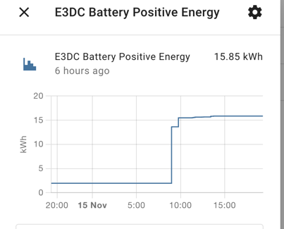

aaahhhhh… what tha …
Where does this now come from?
Energy from the Grid should go into the House.
But here it does look like it went into the Battery…
Grid Tab should be OK with Positive (import) and Solar back to Grip (export).
Solar Panel is single value.
Battery has two entries. Charge and DIscharge.
The E3DC Box does not charge from Grid. Would not make sense.
I cannot explain this. Do you have me tip?

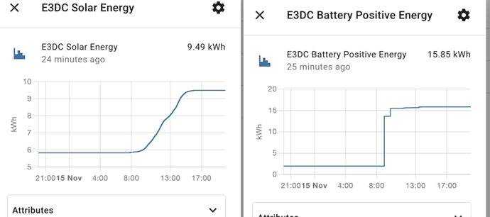

mea maxima culpa! the Peak shows the battery positive power which is usually the action when the solar charges the battery. Totally weird and i do have no explanation for it. Kind of curious as well.
Here is the flow:
And here is the sensor… it suddenly peaked up.
2021-11-15_19-20-22
This is how it should happen. From the solar to the battery.
2021-11-15_19-21-24

The pink line in the energy flow goes from solar to battery, so it looks ok. I don’t understand why you say it comes from grid…

yes, from the color the line looks like it does come from the solar panels to the battery.
But we did not had much sun here in Switzerland the last few days and my SoC on the battery shows 0%.
This peak where it suddenly raised up this morning 9 am . Could it be a maintenance and then the server found data for the sensor? A restart?
But still should it show more than the solar production shows?
am i able to reset these values?
